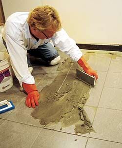

Applying Grout To ensure strong joints, the grout must fill the joints completely at a uniform density. Packing grout with a rubber trowel forces the solid particles to crowd together, which pushes excess moisture out of the joint. To do this, hold the grout trowel at a low angle to the face of the tile and press the grout into the joint from several different directions (Figure 6).
Figure 6. Force the grout into joints by holding the rubber trowel at a shallow angle as you sweep it over the tile from several directions (top). To scrape away the excess, hold the trowel on edge and stroke the surface on a diagonal to the joint direction (bottom).
Backfill any voids immediately. The grout should be forced into all joints — not just pushed around the surface. As one area is filled, hold the face of the trowel at a 90-degree angle to the surface of the tile (with the edge diagonal to the direction of the joints) and scrape away as much of the excess as possible. Job-site conditions will determine how much grout can be spread before wet cleaning can begin. With impervious tiles and mild temperatures, it may be possible to spread hundreds of square feet; with porous tiles and high temperatures, start off with a small area. As a matter of common sense, schedule grout work so that there is absolutely no traffic on freshly grouted surfaces.
