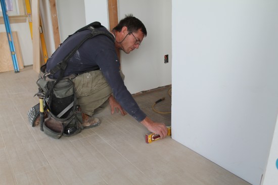

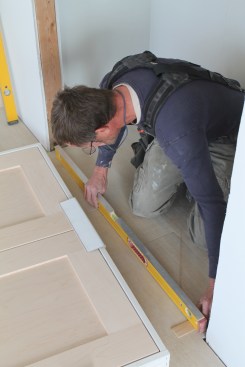

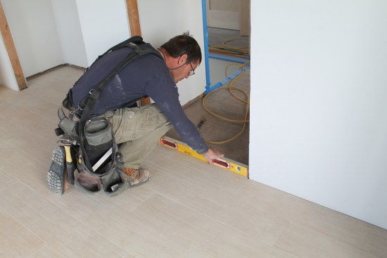

Check the Rough Openings
Start each door with a final check of the opening, making sure that the door will fit and that there’s nothing unusual to contend with. If door location within the opening is critical—to center it in a space, for example, or to align it with another component—note what its exact position needs to be. If there are other doors nearby, check the overall level of the floor to make sure the head jambs all line up. Next, check the floor across the doorway for level and under each jamb to make sure the opening is perpendicular to the floor. If the floor is sloped or stepped, adjust the jamb cuts for the best fit.
Installation starts with a check of the openings. Here floor level is checked between two adjacent door openings. If it is off, the head casings will not align without some adjustment.
Check the level of the floor within the opening and note any discrepancies, which will be addressed when the jamb legs are cut.
The final check is that the floor is level under each jamb leg. If it's sloped, the cut should be adjusted accordingly.

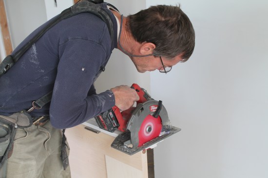

Measure and Cut the Jambs
Jamb-leg length is strictly a function of the door-slab height and the clearance that’s needed above the floor or threshold. In most houses, the height of the jambs rarely varies. Ideally, leave 1/2 to 1 inch of clearance between the top jamb and the header framing to allow for settling and to let the casing bridge slight differences between the jamb and wall finish.

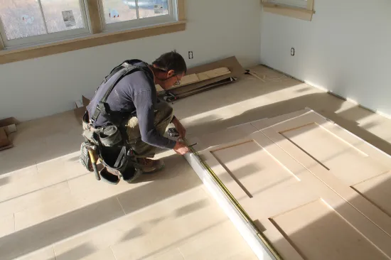

Keeping the temporary fasteners in place tht hold the door assembly together, start by marking the length of the jamb leg on one side.
With the temporary fasteners holding the door assembly together, start by marking the length of the jamb leg on one side.
Next, square a line across the jamb leg at the mark.

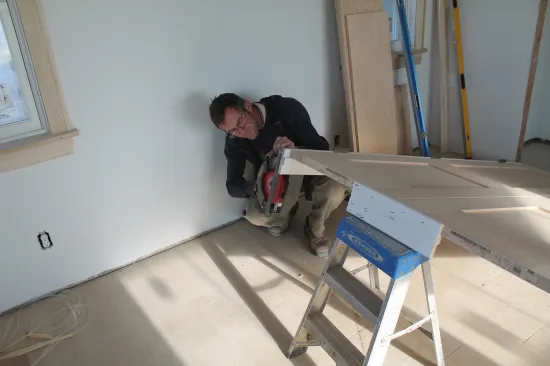

During the initial steps of cutting and fitting, keep in place the temporary fasteners that hold the door slab in its jamb. To cut the jamb legs, roll the unit onto one edge. Then measure the jamb leg, mark it, and cut it to length. Flip the unit onto its other edge and repeat the process. Check to be sure that the hinge screws haven’t come through the back of the jamb; they can quickly ruin a finished floor.
Finally cut the jamb leg to the proper length.
After cutting the first edge, flip the door over and repeat the process with the other jamb leg. Be sure the hinge screws aren't coming through the jamb on the other side—they can ruin a finished floor quickly!

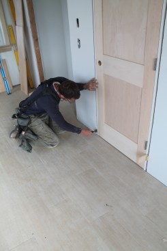

Level the Door Slab in the Jamb
With the door slab still secured in its jamb, stand the unit up in the opening and make sure the head jamb is perfectly level. If it’s not level, set the door down again and trim the appropriate jamb. When the bubble is dead center, release the temporary fasteners holding the door in its jamb, and set the unit in the rough opening. Unless you’ve noted differently, center the door in the opening and secure the hinge jamb just above the top hinge with a couple of shims and nails.
With the temporary fasteners still in place, set the door in the opeing and check the head jamb for level. If it's not dead on, take the door out and make the adjusting cut.
With the temporary fasteners still in place, set the door in the opening and check the head jamb for level. If it's not dead on, take the door out and make the adjusting cut.
If the head is level, release the temporary fasteners and secure the hinge jamb just above the top hinge with shims and a nail.

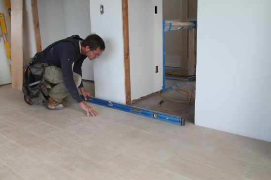

Double Doors: Cut and Set Up
Double doors are trickier to hang than single doors, but the basic process is the same. With the double door shown here, the floor was out of level. Placing a shim under the level showed how much had to be added to the jamb leg to make the head jamb level. That amount was added to the measurement of the longer leg and then both jamb legs were cut. As with a single door, the unit was set in the opening—this time with the temporary fasteners removed—and the head jamb checked to make sure it was level.
For a double door, first check the opening. If the floor isn't level, shim under the level until the bubble is in the middle.

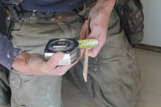

Measure the thickness of the shim where the level was sitting.
Measure the length of the jamb leg, adding the amount of the difference to the length of the leg.

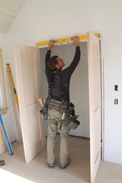

As with a single door, set the door in the opening—this time with the temporary fasteners removed.
As with the single door, check the head jamb to make sure it's level before proceeding.

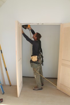

Double Doors: Tweaking the Fit

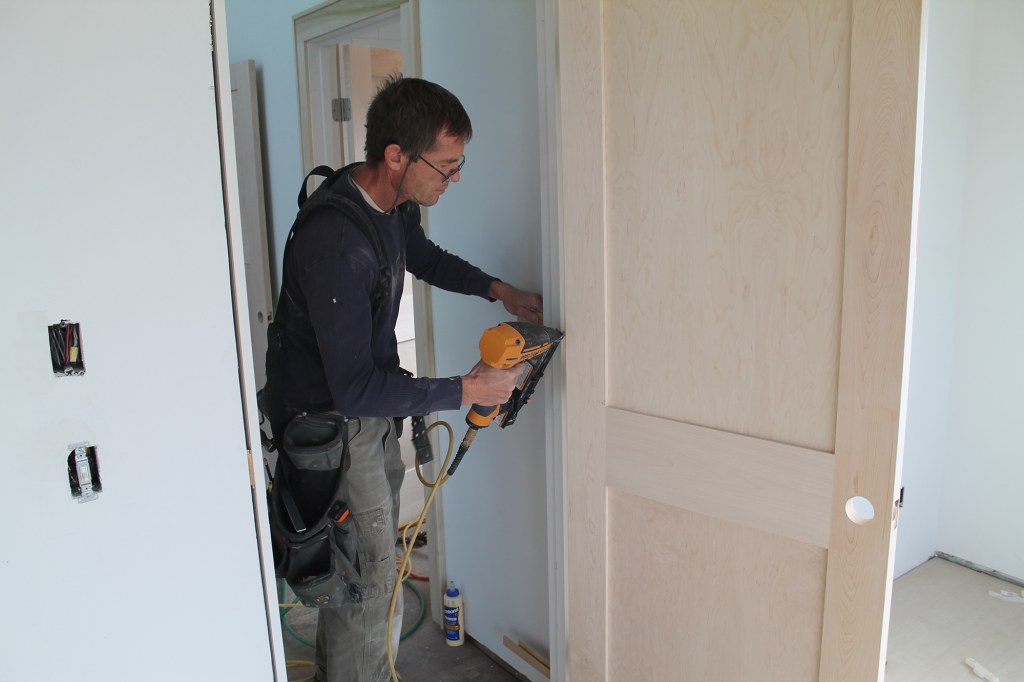

To hang double doors, instead of starting with a set of shims on one side, swing the doors open and shoot a single 2 1/2-inch 15-gauge finish nail through the jambs at each of the four corners. These nails hold everything loosely in place and let you adjust the jambs as needed. Next, shim the top of each side jamb, centering it in the opening. Shoot only one nail through the shims—it’s important to be able to shift the jambs slightly to align the door. At this point, shim and nail the top jamb, using the edge of a level to get the jamb perfectly straight. Don’t nail through the head-jamb shims though; those shims will be removed later after casing is installed on one side. Then, the header framing can’t push on the door jamb if it settles in the future.
To install the double-door unit, start by driving a single nail through the jamb at each of the four corners.

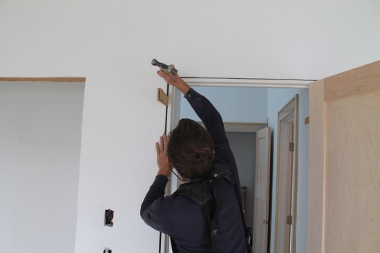

Insert shims above the top hinges on both sides to center the door in the opening, and shoot just one nail through the shims to allow for adjustment.
