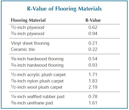

Finished flooring acts as an insulator on top of a radiant floor, and must be accounted for in the design of the system. Ceramic tile provides little resistance to heat flow, so it works well with the low fluid temperatures used in radiant heating. A conventional hardwood floor with 3/4-inch subfloor has an R-value near 2. If the homeowners plan to add a rug on top, it becomes trickier for the designer to meet the heating needs of the room without overheating the hardwood flooring.
The temptation is to crank up the supply temperature to compensate. When hardwood floors are involved, fluid temperatures typically range from 105°F to 125°F for Gyp-Crete type floors, and could be as high as 145°F for staple-up under-floor applications. It’s hard to make assumptions about design because of the variables, but if I’m having a problem reaching a comfortable surface temperature, I’ll add more insulation under the tubing, space the tubes closer together, increase the diameter of the tubing, or suggest a flooring with a lower R-value — anything except jack up the fluid temperatures.

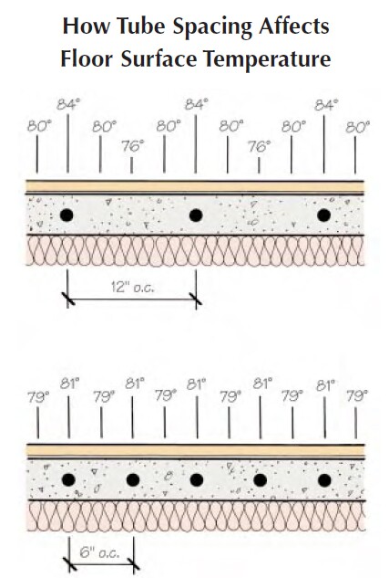

Tube Spacing
Pipes spaced too far apart will create hot and cold streaks — a bad thing for a wood floor, which should expand and contract uniformly. A tubing design that works great in a warehouse with a bare concrete floor is probably not suitable for a living room. Many radiant floor designs are based on tubing layouts 12 inches on-center or more. For hardwood flooring, though, the spacing should be less, ideally 6 to 8 inches. The closer the spacing, the more even the heat will be, and the happier the wood flooring will be.
Each of the floors illustrated here has a 20 Btu/hr. output. Note that with 12-inch on-center tube spacing, the “striping” effect is much more pronounced. Six-inch spacing produces the same heat with a lower surface temperature and a more even heat distribution — both of which are advantageous for hardwood flooring.
In some cases it may be necessary to decrease the diameter of the tubing as the spacing grows closer. Be careful not to exceed the maximum length of each loop, which, depending on the pump size, could be as little as 100 feet for some types of 3/8-inch tubing. Closer tubing spacing means more individual loops. More loops mean more manifolds, which in turn means more advance planning.

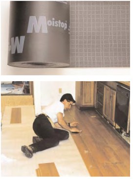

For hardwood strip flooring over radiant heating, always use a moisture barrier like Moistop (top), a fiber-reinforced composite of poly and Kraft paper popular with flooring contractors in the author’s area. Under floating hardwood floors, a pad like AstroBarrier (above) provides a foam cleavage layer and a poly moisture break.
Always Use a Moisture Barrier
The new urethane finishes common on today’s hardwood floors put a moisture barrier on top of the wood. The last thing you want is for the unfinished back to absorb moisture from the subfloor — a common cause of cupping.
Hardwood always used to be installed over resin paper or something similar. With a radiant floor this “cleavage membrane” serves another function — to stop moisture from migrating from the subfloor or Gyp-Crete into the flooring. A moisture barrier won’t help a chronically wet house, but it will buy a little time while a new house dries, and will buffer seasonal moisture changes.
The one moisture barrier not to use under a radiant floor is black asphalt-impregnated felt — that is unless you enjoy the smell of asphalt every time the heat comes on. A sheet of poly would probably do the job, but the installers we work with prefer a moisture-retarding membrane such as Henry’s Moistop. This product is 12 mils thick, and consist of a heavy-duty polypropylene woven fabric, coated on both sides with ultraviolet-resistant polypropylene.

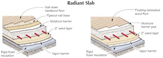

Whether you install nail-down strip flooring (left) or a floating laminated wood floor (right) over a radiant slab, be sure to include a moisture barrier on top of the concrete as well as below the slab. For nail-down flooring, lay a single sheet of 3/4-inch plywood or a double layer of 1/2-inch plywood as a nail base.
Slab Systems
When I have my choice, I always prefer a system using thermal mass over a staple-up system. The mass helps even out temperature swings, which benefits the wood floor. I see no real differences in performance between full-thickness slabs and thin slabs poured over wood framing. With thin slabs, I like Gyp-Crete because it’s less likely to crack than a Portland cement mix, though it’s more expensive. Another thermal mass option we’ve been using is to substitute dry sand for the Gyp-Crete.
The maximum fluid temperature I use in a concrete or Gyp-Crete system is 140°F, to keep thermal swings and possible fracturing in the concrete or Gyp-Crete to a minimum. The only times the design temperature would need to approach 140°F is if sleepers are laid on top of a slab and the hardwood flooring is installed on the sleepers, or if plywood is used to provide a continuous nail base. In general, I prefer to set the sleepers close together for good nailing, pour the thin mix in between, and lay the flooring directly over the slab and sleepers.

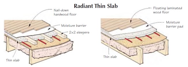

When installing nail-down strip flooring over a thin slab (left), the author recommends spacing the sleepers 8 inches on-center to provide good nailing. For wider sleeper spacings, you can use a plywood nail base, but the fluid temperature may need to be raised to overcome the plywood’s thermal resistance. A floating wood floor system (right) installs directly over the thin slab.

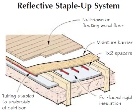

Staple-Up
In retrofit situations, when the wood floor is already in place, or when the designer, for whatever reason, doesn’t want to pour a thin slab, my second choice is a staple-up with a reflective insulating barrier below. This might be foil-faced rigid foam board or a reflective barrier with batt insulation underneath.
Some installers use aluminum plates to help spread the heat sideways and prevent the “striping” effect. I don’t like the plates for a couple of reasons: They’re expensive — about $3 apiece — and they’re noisy when they’re walked over and when they expand and contract. I’ve found that as long as I use the reflective barrier, stapling the tubes directly to the subfloor without plates works fine. I’ve never had a complaint about striping as long as the floor is designed with minimum water temperature in mind.
Another variation of this system, also designed to prevent striping, is the “suspended tube” approach — where the tubing hangs an inch or so below the subfloor with the reflective barrier below. This just makes it harder to install the tubing with little to gain for the trouble. I’ve seen this technique misapplied, where the tubing was stapled to the sides of the joists — which does a good job of heating up the joist. I prefer the direct contact of the tubing with the subfloor.
Staple-up systems require slightly higher fluid temperatures, with the maximum I’d use being around 160°F. Usually, it takes about 130°F to 140°F in the joist bays to produce an 80°F surface temperature. A critical factor in designing any staple-up system is to make sure that the insulation R-value under the tubing is at least four times as great as the R-value of the materials above the tubing. The goal is to direct the heat up.
