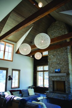

LED lights can provide beautiful and functional illumination in a full range of color temperatures and intensities, to support any aspect of life in a home. The LED chandeliers and pendants Tim Mathieson used in the vaulted living space above mix well with daylight.

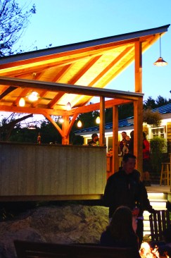

Warm outdoor lights enhance an evening cookout.

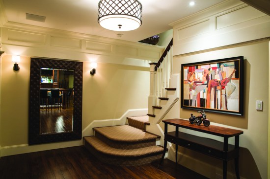

Sergio Mazon’s custom lighting design specified LED luminaires for the basement living space, including a ceiling pendant, wall sconces, and accent lighting for art work in the entry.

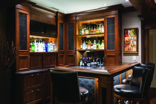

Accent lights and downlights for the bar

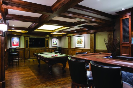

Cove lighting and art lighting for the billiard room

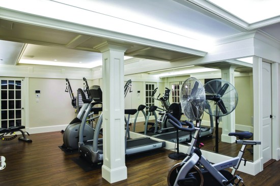

Color-tunable lights for the home gym are suitable for either a vigorous morning workout or a relaxing evening yoga session.

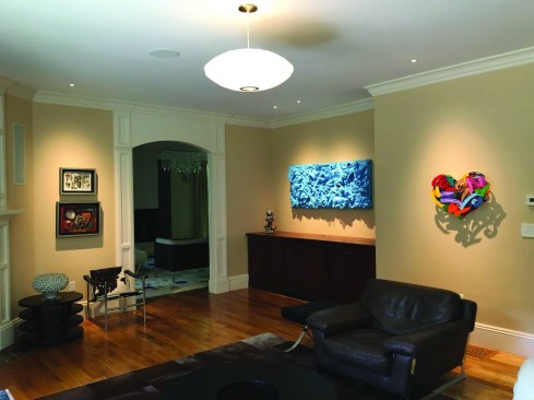

Small, discreet recessed fixtures were aimed at featured artworks.

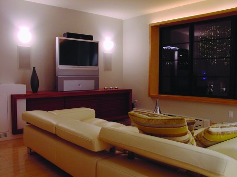

Expert touches in this Sergio Mazon lighting project help this house work and feel better: Wall sconces sit behind the TV so as not to cast glare on the screen.

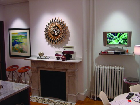

Accent lighting makes artwork pop.

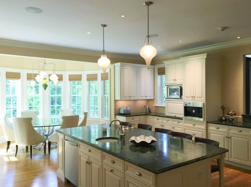

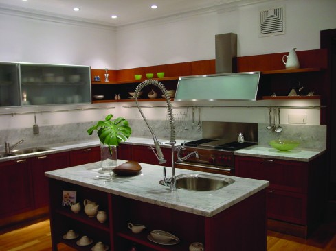

Bright kitchen lighting provides a well-lit workspace while avoiding glare.

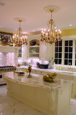

This Sergio Mazon project, which dates back many years, shows the challenge designers face when trying to replicate traditional styles.

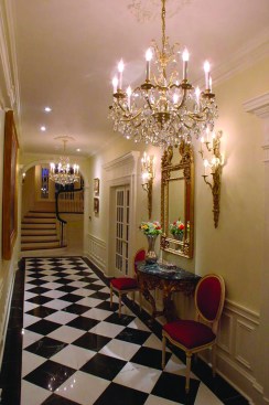

The chandeliers in this kitchen and hallway have halogen bulbs, as do the hallway sconces. LED replacements for the 15-watt lamps are available, but Mazon said, “No LED is going to replicate incandescent or halogen precisely.”
