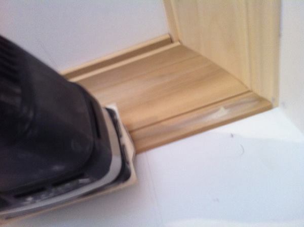

The problem is, and has been, in trim heavy custom homes, we always see certain profiles that have historically left us with no practical option for sanding other than our hands. No sanders that we had looked at could tackle custom profiles effectively because their shapes simply could not conform to the trim stock.
A Suitable Solution
We have found a solution to this problem in the form of a the Festool LS130, which has multiple attachments that are well suited to custom shapes and sizes on trim. And, this can be done with remarkable ability to prevent dust from becoming airborne in the process. In this video, we have a poplar trim package that is at the nail hole filling and sanding stage. In the past, we would have taken more time to meticulously fill the holes, to make the hand sanding easier. Often, it would be necessary to reskim some of the holes after hand sanding. These moves added time to the prep process especially when time spent manually vacuuming dust is considered. Now, we can more quickly pack the holes with a heavier bodied filler, power sand faster and collect the majority of the dust all in one sequence. The bottom line is, we are most profitable when we are applying finishes, not preparing to apply finishes.
Nail hole sanding is just one small step in the overall sequence of trim prep, but it is one where many hours can be saved. We are doing the same type of exploring in all aspects of interior surface prep for painting and will continue to share the results. Coming soon, we will share techniques for accelerating wall prep (drywall skim sanding) with more power.
