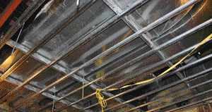

One approach uses spring isolators, which are basically acoustic shock absorbers. They can be mounted on the floor, walls, or ceiling; by cushioning the impact of sound waves, they prevent them from spreading to framing and other rigid materials like pipe and ducts. Some spring isolators can support hundreds (or even thousands) of pounds each, so they can be spaced farther apart than other types of isolation hardware.
Controlling structure-borne noise requires acoustic isolation or decoupling of the finished space from the framing and other rigid materials. This can be done by using double-stud framing to build a "room within a room" or with specialty products such as these spring isolators.
On the ceiling of this room, spring isolators support heavy-gauge steel framing that will ultimately be covered with a layer of 3/4-inch plywood, a layer of mass-loaded vinyl, and then drywall. Multiple pipes and ducts didn't leave a lot of room for regularly spaced mounting hardware in this high-end home theater, so spring isolators — which generally have a higher load capacity than other types of isolation hardware — were a good choice.

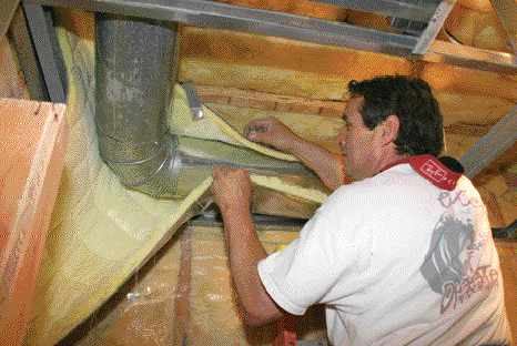

Ductwork. Perhaps the most troublesome spot in any acoustically treated room is the heating and air-conditioning ductwork.
Because their smooth, hard interior tends to amplify sound waves, and because the large openings at either end make it easy for sound to get in at one room and out into the adjacent one, ducts are an ideal conduit for sound.
To reduce sound transmission, I wrap the exterior of ducts with an insulation that’s similar to the product I use on pipes. And I install fire-rated acoustic foam or fiberglass duct liner on their interior.
Preventing ducts from spreading sound throughout the house is a two-step process. First, fire-rated acoustic foam or fiberglass duct liner is installed on the ducts' interior to deaden any sound that gets inside.
Next, the ducts’ exterior is wrapped, which ensures that very little sound will penetrate in the first place. Both steps are especially important in basement home theaters, which often have many ducts in the ceiling.
