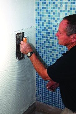

Mesh backing lets you install the tiny glass tiles as a single sheet (1). Start by spreading a thin, even layer of thinset on the wall. Comb the thinset in one direction using a notched trowel with the recommended-size teeth.

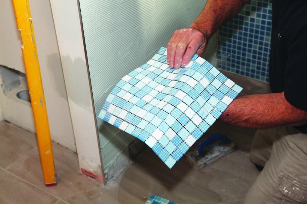

Next, flatten the ridges with the flat side of the trowel.
To achieve 100% coverage, spread the thinset on the wall with the flat side of the trowel, as close to perfectly smooth as possible. Then switch to the notched side of the trowel (use the appropriate-size teeth for the size of the tile) and comb the thinset evenly in one direction. Last, go back to the flat side of the trowel and flatten all of the ridges of the thinset without scraping off any of the thinset, while continuing to maintain an even thickness.

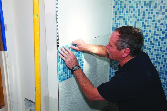

Then press the tile into the thinset and move it side to side slightly for 100% coverage.
When the thinset is ready, push the sheet of glass tile into it, shifting the tile back and forth until it is 100% embedded in the thinset (3). The white mesh on the back of the sheet should disappear completely into the thinset. Occasionally, some threads of the mesh might be visible next to the grout joints, but only if you are looking at the tile at an angle. When in doubt, try out your installation methods on a small area first.
