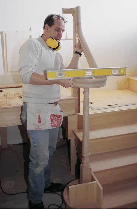

Using a pitch block. To calculate a gain or drop in post height, I make a simple gauge called a pitch block for every stair I build. A pitch block is just a scrap of finish lumber or plywood, cut square to the height and depth of a single riser and tread, then cut diagonally from corner to corner (see Figure 1).
Figure 1.A pitch block is a simple gauge that’s useful for determining post and rail height adjustments on offset newels. It’s easily made by marking the diagonal between tread and riser on a square-cut lumber scrap (top), then cutting it to the line with a radial arm saw (bottom).
Measuring a plumb line anywhere along the base, or tread line, of the block shows the exact rise relative to the horizontal distance traveled, and thus how much to add to, or deduct from, standard post height.

Adjustable newels are similar, but instead of having a fixed dowel bottom, they’re end-bored for a separate anchor dowel and can be trimmed to the exact length needed (Figure 2). I prefer the adjustable option so that I can fine-tune the railing height as needed.
Figure 2.Adjustable starting newels are end-bored for an anchor dowel, which permits trimming them to length as needed (top). Once the position of the starting newel has been determined with a paper template (middle), the starting step is drilled through to the subfloor and the newel is dropped into place (bottom).
The starting step is drilled full-depth, through to the subfloor, to accept the newel dowel. A starting volute comes with a paper template, used to determine the newel location on the starting tread. Although baluster locations are also indicated on the template, I ignore them — they almost never match the on-site spacing.
