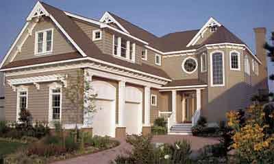

A $3.5-million beachfront home in Longport, N.J., exemplifies the work of Haffelfinger & Standeven Construction, which has made elegant, durable exteriors a prime selling feature of its homes.

Yes, we've made exteriors a large part of the business. On some of our houses, the exterior alone may be $80,000 or more. We're able to offer a durable exterior — something that can hold up to the constant wetting and drying, the salt, the sun — without sacrificing detail or compromising the look.
Five or six years ago, everything had to be cedar to get fine detail. That's when I started experimenting with different trim boards. With the cellular PVC, like Azek, we were able to do things like fluted columns or 3/4-inch beads on fascias — details that we couldn't do with other composites. I like to do full window surrounds, a lot of arches, circle windows, arched walk-through openings in cabanas, porticoes; anything that would have been constructed in cedar that had a lot detail, any overlay and cornice work, we can now do in some type of composite or vinyl. We also use Fypon foam moldings, fiberglass columns, vinyl railings, decking, and siding — all materials that can hold up in the constant damp and high humidity. And they will hold paint longer, if they need to be painted at all.
