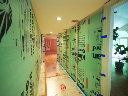

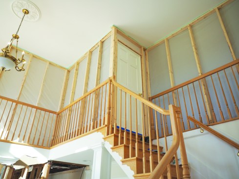

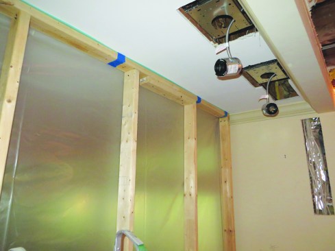

Constructed wood walls are the most durable way to block off an area.

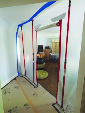

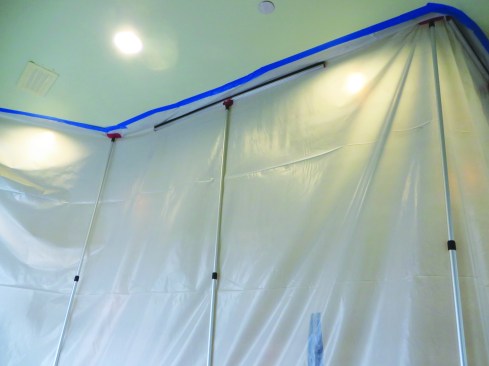

But aluminum or steel pole systems are quicker.
Dust Barriers
There are three standard ways to build dust walls: For long-term or high-strength walls, constructed wood frames covered with plastic or sheet goods are the most durable. We seal the perimeter with tape or sill sealer foam. For short-term use, pole-type systems (such as ZipWall) are easy and inexpensive. And simply taping plastic to ceiling and walls can work for the short term, if there is no wind load.
When possible, set up dust enclosures where they won’t need to be moved for the duration of the project, including painting and floor finishing.

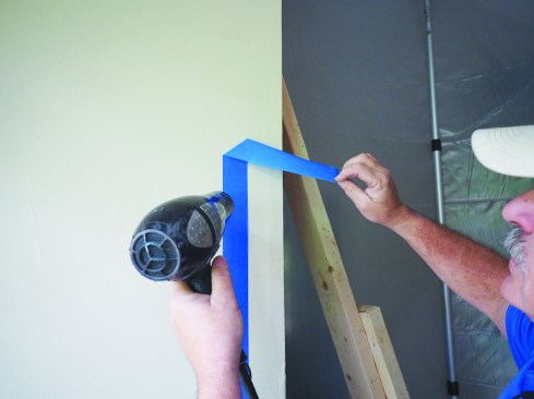

Plastic should be taped to walls and ceilings, but stay away from finishes that could be damaged when you are removing the tape. A hair dryer can soften adhesive to help prevent damage when tape is removed.

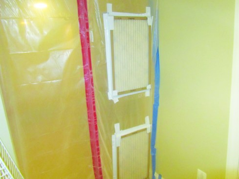

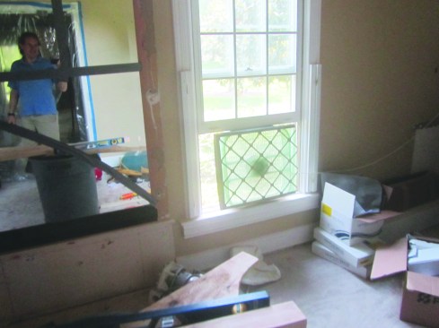

Here’s a tip: Install furnace filters in the dust wall to allow wind to blow in and out without carrying too much dust through. This helps keep wind pressure or door slams from blowing the wall down.

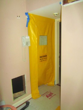

Once the dust wall is in place, you need a way in or out of the work space. One solution is to use an actual hinged door (such as an interior door being demoed from the project area, a sheet of plywood on hinges, or a $50 home-center screen door with plastic stapled to it).
Another common method to provide access is to install a double-zipper door with self-sticking zippers (some brands come with metal hooks to hold the flap of plastic out of the way when the door is opened). And finally, overlapped plastic sheeting works well: Cut a vertical slit in the dust-wall plastic, then tape a 3- to 4-foot-wide piece to cover the hole. This method is inexpensive and convenient, and, with negative air pressure, will keep dust in the work area. (It’s even endorsed by the EPA Lead Renovation, Repair and Painting training.)
A wood screen door or demoed interior door makes a good dust containment door.
Other options include zipper systems and commercial doors.
However, these tend to be expensive.

Tape furnace filters to holes in the plastic to control dust while relieving air pressure from wind.
It’s easy to tell if the work area is under negative pressure: The plastic will be sucking into the work space. If the plastic is blowing outward, the wind is stronger than the exhaust fan, and dust will escape. To fix this, either seal more holes or use a more powerful fan.

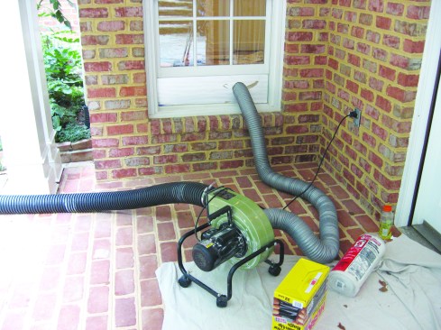

Fan choices range from a cheap box fan in the window ... to carpet dryer fans ...
Fan choices range from a cheap box fan in the window … to carpet dryer fans …
Fan Choices

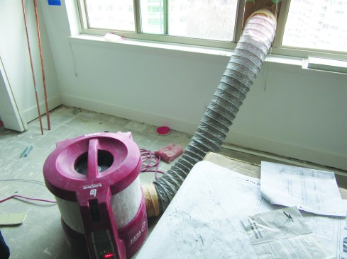

For less than $25, a box or window fan works for a small area (one or maybe two rooms). It won’t work for a larger space, like an entire condo—it’s not strong enough. Use cardboard, foam board, or plywood to fill in around the fan in the window. A furnace filter can help keep the fan clean and running well.
... and dust extractor fans.
… and dust extractor fans.
A restoration “carpet dryer” fan, priced at around $200, can be installed with ductwork on the inlet or the outlet side. These units are available for rent. Use a filter to protect the motor from dust.
A woodworking dust extractor (priced under $200) can be placed outdoors with a 4-inch flexible drain pipe used as a duct into the interior room work space.
At the top end are air filter systems that come equipped with HEPA filtration. The author recommends the filter systems for situations where blowing dust out of the window would create a nuisance for neighbors.
There are many situations (such as homes on small lots, townhouses, and condos) where blowing dust out of the window is a bad idea. For those cases, I suggest using an air filtration device (also called a negative air machine or a powered air scrubber). These cost $500 to $1,500 and are available for rent. They’re designed to move large amounts of air while filtering it; most units are equipped with HEPA filters.

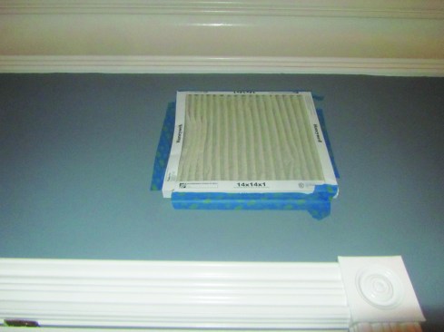

Use filters on returns to reduce dust entry. Middle-level pleated-media filters are the best choice; the finest filters clog too quickly, and the cheapest don’t catch much. But any filter is better than none and will do in a pinch. Filters don’t need to fit the duct opening exactly; tape the filter to the wall over the entire return grille. Consider using an inexpensive pre-filter material in addition so the expensive filter will last longer.

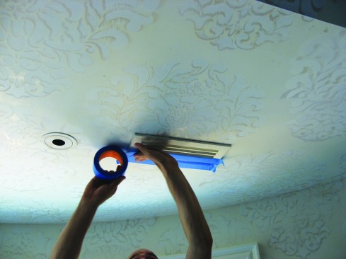

The author advises taping over HVAC supply registers ...
The author advises taping over HVAC supply registers …
... and taping filters over return registers.
… and taping filters over return registers.

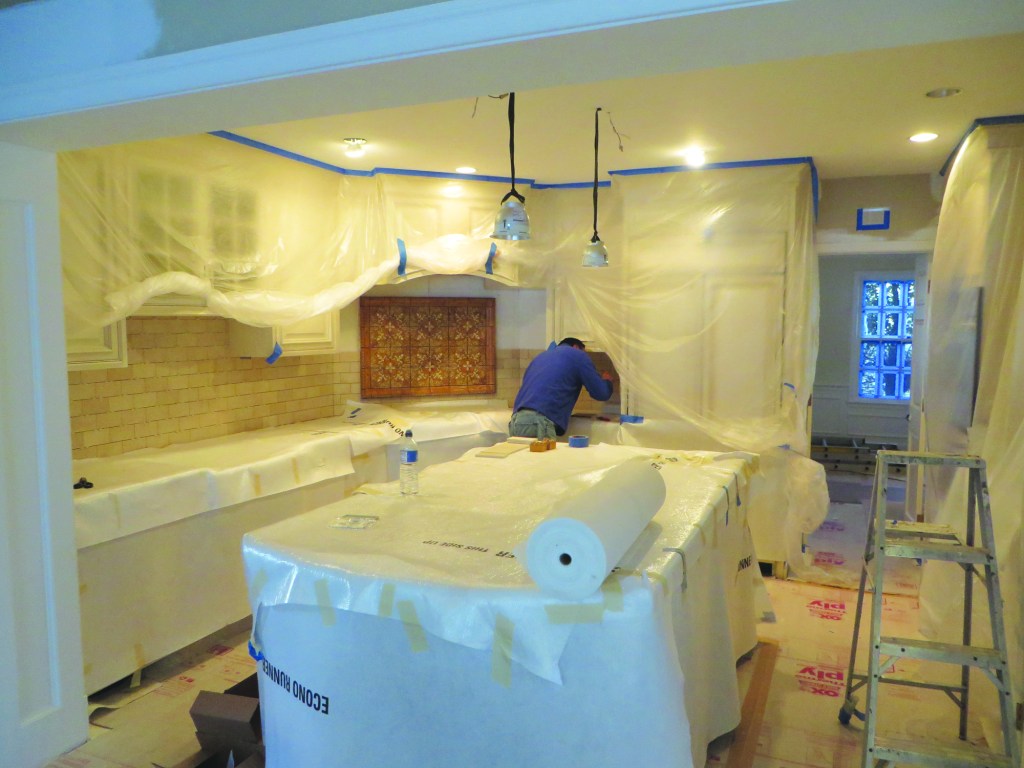

Protecting Surfaces
The homes we work in commonly have valuable and vulnerable surfaces such as hardwood, carpet, and tile. Here are some tips on protecting those surfaces while you work.
Again, the first rule is to do no harm. Avoid using adhesives on surfaces that are hard to repair. Don’t tape to wallpaper, faux finishes, cabinets, or hardwood floors. Tape to shoe molding or painted baseboard rather than to hardwood floors. Tape to trim or painted ceilings rather than to faux-finished walls or wallpaper.
To remove tape, pull slowly and at an angle, parallel to the surface (instead of pulling straight out away from the surface). Use a hair dryer (not a heat gun) to warm up the adhesive.

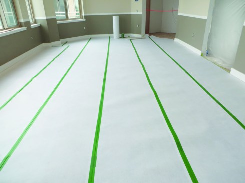

Hardwood floors. For hardwood floor protection, our standard is two layers: one soft layer sealed against dust, and a second, strong layer for impact protection and easy cleaning. For newly-finished hardwood, a typical base layer is unfaced tacky felt; for most floors, we use tacky felt with a plastic facer.
An example of unfaced tacky felt is Surface Pro from KS International (dropcloth.com). It is not liquid-proof and allows the floor beneath to cure. It should not be covered with airtight materials during the curing phase. An example of tacky felt with a plastic facer is Econo Runner from Protective Products (protectiveproducts.com). It has a plastic top surface that blocks liquids.
For protecting wood floors, he advises starting with a base layer of tacky felt.
Then add an impact-resistant layer of durable sheet goods over the top of that.
Other base layers are less protective, more expensive, or more slippery. Paper layers are not protective enough, even when fully taped. Engineered floor underlayment (felt with a plastic top), found at home centers, is protective but slippery and expensive; we use this only if we don’t have time to get tacky felt with a plastic facer.

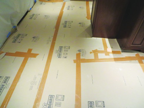

Taped sheet goods provide physical protection. Hardboard, 1/8‑inch structural board such as ThermoPly, or cardboard such as Ram Board or Flexboard (from Protective Products) are good options.
Hardboard is the most durable and easy to clean of these choices; the painted version is less slippery. Eighth-inch structural board is easy to fold for stairs, jambs, and the like. Cardboard is less expensive and easy to install, but it is not nearly as protective and is hard to clean. Only cardboard should be used on newly finished floors, because it allows curing to take place.

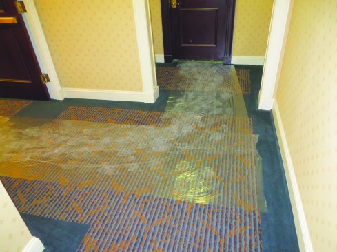

Carpets. For protecting carpets, we use Carpet Protection adhesive roll plastic, supplied by Protective Products; other products we’ve used have left residue on the carpet, so be careful to use a proven product. In any case, the plastic must be removed and replaced, or it can become very sticky and hard to remove. It has a limited life in service—usually less than two weeks.

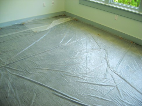

Tacky felt products work well, even on carpet. Plastic sheeting (2‑mil or thicker) can be used to cover an entire room. Canvas tarps are acceptable for short-term use, but they can be a trip hazard, so exercise caution.
Whole rooms can be protected with a sheet of 2-mil or thicker poly.

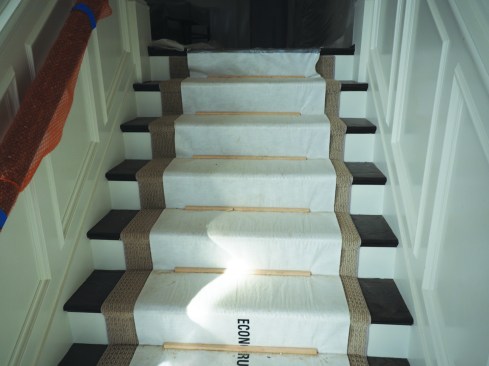

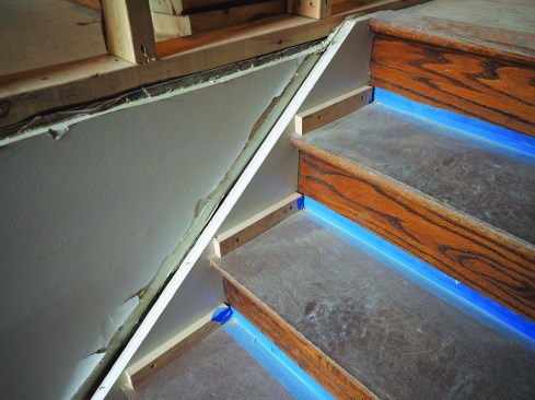

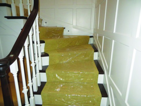

Stair protection. For carpeted stairs, drop cloths are a trip hazard and shouldn’t be used. Carpet Protection adhesive plastic works well. A 24-inch strip is usually easier to install than a complete 36‑inch cover. Use the special “stair” roll with reverse adhesive winding. Tacky felt products also work well. Use wood strips nailed to the risers with 18-gauge nails to hold roll materials.
Hardwood stairs can be protected using hardboard or plywood tread covers, secured to skirtboards using cleats.
To protect hardwood stair treads, hardboard or plywood tread covers can be tacked with 18-gauge or smaller nails; holes are usually not visible later. Tread covers can be built with a cleat at the back and attached to risers, or with cleats at the sides attached to skirts, if holes in treads are unacceptable. Use tacky felt below for dust protection.
Tacky felt products without a hard cover are a good medium-term option; use strips tacked with 18-gauge nails to hold the roll material in place. Other roll protection is fine if you can tape it to the skirtboards or risers.

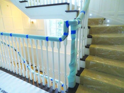

For stair railings, the author recommends wrapping the railing in sill sealer and tape.
You can add a plastic layer on top of or under sheet goods. Plastic doesn’t prevent physical damage, but it does control dust and liquids.
Sill sealer or other flexible foam is good for wrapping railings and fixtures. Tacky felt is also good and can be cut on the roll with a miter saw into narrower widths. Cardboard and old carpet being demoed out (fuzzy side to the railing) are less expensive options that also protect well.
Foam board works well for protecting walls.
For covering walls, foam board, roll foam sheet, cardboard, fanfold, or corrugated plastic sheet are good. Even 6-mil plastic is fairly protective.
