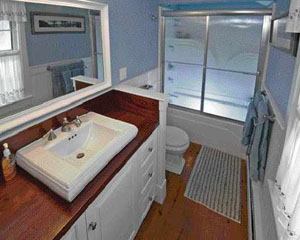

Despite its cathedral ceiling, the central area still felt narrow, so we expanded it visually by positioning the vanity and a large framed mirror directly across from the existing window. The mirror helps anyone using the sink feel more connected to the outdoors and maximizes natural light.
To control costs, we reused the original oak vanity cabinet, but we tore out the one-piece plastic counter-and-lav unit. We installed a custom-made mahogany countertop and backsplash, then mounted the top of a pedestal sink (all of the new bathroom’s fixtures are Kohler models). This lav’s 34-inch height is much more comfortable for an adult to use than the original sink’s 30 inches.
Finally, we trimmed the room with beadboard wainscot; painted both it and the vanity cabinet white; and laid new wide-plank pine flooring that matches the rest of the home’s floors. We face-nailed the planks using hand-cut nails, then finished them with tung oil to enhance that old-house feel.
