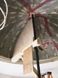

Next we stapled up a poly vapor retarder and a layer of stucco mesh pieced together from narrow strips (we added short nailing blocks to the ribs for better fastening). Now we were ready to finish the interior. The small size of the dome worked against us here; there was little room to work and the surface was sharply curved.
So we assembled a self-centering, rotating screed out of one of the plywood cutoffs, a piece of one-inch black iron pipe, and some scraps of lumber. The ends of the pipe fit into 1 1/4-inch holes bored in blocks secured to the apex of the dome and the floor directly below.
This solution worked pretty well. We pressed the stucco base coat into the mesh with gloved hands and turned the plywood screed to strike it off at a uniform thickness, working in sections because the material set up quickly. Since the plywood base ring was slightly smaller than the base of the dome itself – forming a ledge that would later accommodate a string of rope lights – we had to disassemble and remove the screed between coats. Then we used a belt sander to remove a small amount of material from the leading edge to account for the thickness of the next coat.
