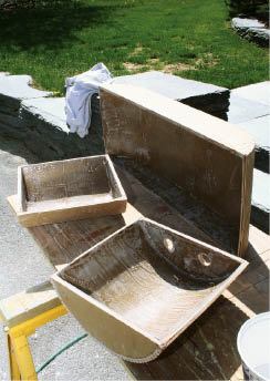

My design-build firm specializes in bathroom remodels, and I do a lot of custom tile showers. One job presented me with a new challenge: The homeowners wanted shower niches with curved backs, which they believed would look more interesting and be easier to clean than squared compartments. Since I couldn’t find any prefab niches with rounded backs, I decided to make my own — three in all (1). I used fiberglass and MDO (medium density overlay) and drew on a technique I had learned working in a boat shop years ago.
First I sized each rough form so that the mosaic tile layout would fit without any cutting (2). I made the forms from 1/2-inch MDO, kerfing the backs so that they’d bend smoothly around the top and bottom pieces (3). Waterproof wood glue and narrow-crown staples hold the assemblies together.
Then I covered the interiors with fiberglass cloth and four coats of resin (4), sanding between coats to smooth out ridges and provide tooth for subsequent coats. A pneumatic die grinder with a flexible sanding pad (5) works great for this task. I found that the fiberglass resin dries in 30 minutes or less, depending on the temperature and humidity. I also sanded the top coat, to help the trowel-on tile waterproofing membrane adhere.
Next I placed the niches in framed openings and had my tile subcontractor integrate them into the Hardie tile backer (888/542-7343, jameshardie .com) with Hydro Ban waterproofing (800/243-4788, laticrete.com). Hydro Ban spans small gaps and builds up better than other products we’ve used (6).
The finished niches were outfitted with low-voltage lighting, which highlights the decorative objects placed inside (7).
Making the niches took two full days. Fortunately, I did this part of the job on a time-and-materials basis.
