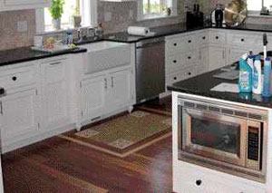

I've always admired the look of wood flooring in the kitchen, but over time the area in front of the sink can get worn, or may even cup from water exposure.
I came up with a solution that I first tried in my own home with great success — a tile "rug" set flush with the wood floor (1, 2). It's become one of our signature details and has inspired many favorable comments.
Before installing the flooring, I lay out the rug area using an inside dimension based on tile size. I prefer rectangles because they mimic the shape of a throw rug.
I picture-frame the rectangle with either the same flooring material or a combination of wood species. Countersunk screws secure the frame, and bung plugs hide the screws. Variations are endless: On one recent job, we picture-framed the tile with a border of cherry and bird's-eye maple (3).
Next I fill in the tile substrate. Typically, the minimum subfloor thickness under tile is 1 inch, but since the rug area is so small, I don't bother with thickness buildups. I've found that 1/4-inch backerboard works nicely, depending on tile thickness, and I've also used Schluter's Ditra — the orange plastic membrane with a grid pattern. The Ditra gives a cushioning effect; the last time we used it, the customers asked whether there was a cork layer under the tile.
On an upcoming job, a customer has asked us to install an electric radiant-heat mat under the tile.
We've also retrofitted the rug into an existing floor, using a site-made template, a plunge router, and a sharp chisel. Scoring the flooring first with a utility knife helps with chip-out.
Most customers prefer a natural-stone mosaic. After setting the stone tile, I protect it with a high-quality sealer, Impregnator Pro from StoneTech (www.stonetechpro.com).
