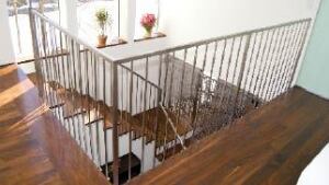

I've mostly built traditional stairs using manufactured rail parts. Recently, though, an architect asked me to install a contemporary stainless steel handrail to fit a 10-by-10-foot opening. The L-shaped balustrade and the horizontal guardrail at the landing were to be fabricated from 1-inch square tubing, with 3/8-inch solid square balusters 4 inches on-center (1). Because the metal shop was several hours away from the job site, one of the first things I did was make an accurate full-scale template on sheets of plywood, fitting it to the rough stair carriage and providing actual dimensions. After getting approval from both the architect and the building inspector, I drove the plywood templates to the shop. Though this process took a couple of days, it was time well-spent; the actual installation went smoothly and took only about a day.

The architect wanted the fasteners for the balustrade to be concealed, but I was concerned about the rail being strong enough to pass inspection. The final design called for 1/4-inch-thick tabs welded at right angles to the end of each baluster, countersunk for structural screws so they could be fastened directly to the subtreads (2). Similar mounting brackets at the bottoms of the newels allowed for rock-solid attachment into the framing (3, 4). I used an angle grinder and utility knife to cut away the drywall and corner bead so I could screw the brackets directly to the stringers and headers (5).

Along the landing, I used a router to make mortises for the baluster brackets in the subfloor (6, 7). To ensure accuracy, I first clamped story poles to the top of each rail section and marked the baluster locations, then transferred the layout to the landing (8, 9). The mortises are 1/2 inch deep to accept the 1/4-inch tabs and create a 1/4-inch reveal between the finish floor nosing and the top of the drywall (10).

Before installing the walnut treads and landing nosing, I fitted notched 1/4-inch hardboard spacers around the baluster tabs, holding them 1/4 inch back from the edge to create the reveal between the drywall and treads (11, 12). Later, my drywall sub came back and patched all the bracket cutouts, leaving clean lines and invisible attachments (13, 14).
