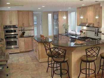

Direct vs. indirect lighting. Pointing lights directly at an area throws the most light, but it can also produce harsh shadows, especially if the lamps are close to what you’re shooting. I generally use direct light only when an area is deep in shadow or when I need to open it up a bit to emphasize it. To soften the shadows, I put diffusion material on the lights.
Bouncing the light off a wall or ceiling instead of shining it directly produces better, shadow-free lighting. Keep in mind that light bounced off a colored surface — like a painted wall — will cast that color into your shot. Another option is to reflect the light off a large white card, such as foam core or a white board. Although you’ll lose about half your light’s output by bouncing it, the results will be much more natural-looking.
