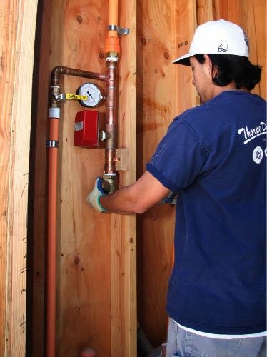

Risers. In a stand-alone system, the sprinklers and overhead piping are supplied through a riser. The riser contains a check valve and a drain valve, which is used to empty the system for repairs and to verify that there’s water inside. Many risers also have a pressure gauge, though it’s not required.
Most stand-alone systems are equipped with a flow detector, an electric device that sets off an audible alarm when water flows into the sprinkler pipes. Flow detectors aren’t required if the house has smoke detectors, but they’re typically included as part of the sprinkler system anyway.
A stand-alone system’s main control valve must be upstream from the connection to the domestic water so that the sprinklers can’t be shut off without the domestic water being shut off as well. (Exceptions are when the control valve can be locked open or when it’s monitored by a central alarm station.) This safeguard makes it less likely that anyone will leave the sprinklers off.
