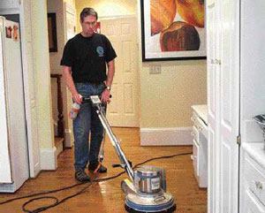

Furthermore, recoating can now be completely dustless. A big advantage of the process is that there’s no sanding and no screening involved. Instead of screens, I use synthetic pads (3M maroon pads) on the buffer, which don’t leave scratch marks.
Whenever I’m buffing a dry floor to prep for applying the finish, I strap on a backpack vacuum (I have BonaKemi’s Back Vac), which picks up any dust. The dust-containment equipment available these days is so much better than it used to be that there’s no excuse to generate dust during a recoat.

Recoating the floor. After a thorough cleaning, I have a choice. If the floor is reasonably flat, I’ll simply buff it with the maroon pad to scuff the previous coating so the recoat bonds well. After doing this I can immediately apply the finish coat.

Luckily, there are products called renovators that do a good job of bringing these surfaces back to life. As with recoating, application requires nothing more than a buffer. Both Dura Seal and BonaKemi have renovators in their lines of stains and finishes.
To apply the renovator, you cut in the edges of the room with a brush. Then you mop the material onto the field of the floor with a lamb’s wool applicator. It’s best to work in manageable areas — say, half a bedroom at a time. Break larger rooms up into several sections.
Allow the renovator to sit for about 15 minutes, then start working it with a steel-wool pad. It will gradually lift the wax and dried oils from the original installation and put them into solution. This forms a discolored residue on the surface that you should remove with rags.
One of the best aspects of this process is that the renovator itself, as it emulsifies the old products, reseals the surface while you are working it with the steel wool. To add a little punch, you can put a small amount of color in the renovator.
The net effect is that the floor undergoes a fairly dramatic visual improvement and is also pretty well sealed — so you can either buff the surface with steel wool to get an oil look or apply wax to get some luster.
