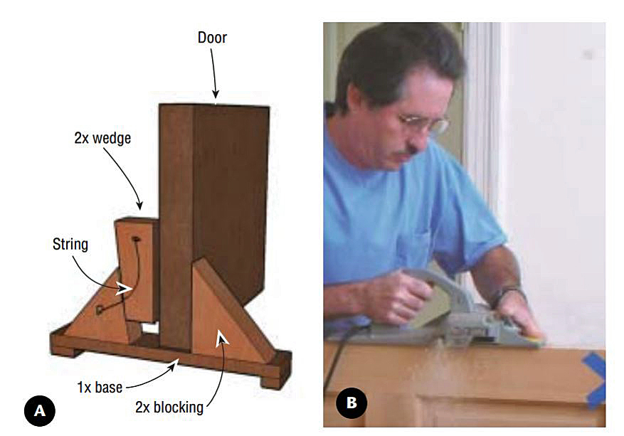

First, put together a good door bench or a door stand. You can cobble a stand together from some scraps of 2-by and 1-by (photo A below), or you can make a full-blown bench. I’d suggest making the bench. A good door bench has a lot of uses. The legs fold up, so the bench is easy to store and transport, and once you start hanging doors, you’ll never stop — there’s good money in it. (See “Hanging a New Door in an Old Jamb,” 8/99, for more on building a door bench.)
But it’s the tools that cost real money. I’m figuring you already own a good-sized drill, a cordless driver, and a circular saw, so a plane might be your most expensive purchase. As a full-time door hanger, I prefer a Porter-Cable 126 (photo B above), which is also discontinued, though you can still find them used on eBay and other places on the web. For just a few doors, you can also use a regular plane, like the Bosch PL1632, one of the few multi-use planes equipped with an adjustable bevel guide (around $130).

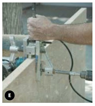

For boring doors, you could buy a good-quality hole saw for the cylinder and a spade bit for the edge bore, and live dangerously! But if you can, when it comes to boring doors, break the bank and go all the way. Templaco sells a great kit (BJ-115 , about $500) that includes all the latch and strike templates you’ll ever need, plus the boring jig (photo E, left) and carbide spurs bit. You won’t regret buying it. (See “Installing a Cylindrical Latchset,” 12/00.)
