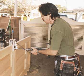

In most cases, the latchset is mounted between 35 and 38 inches from the floor, but on panel doors, the latchset should be centered in the lock rail. Always drill the face bore first, then the edge bore (see Figure 1). This takes the guesswork out of the edge bore — when the bit falls into the hole, you're done.
Figure 1. A lock boring jig ensures accurate hole placement. The author always drills the face bore first (top), then the edge bore (bottom).
A hole saw and a spade bit will do the job, but I prefer to use a lock boring jig, such as those made by Porter Cable, Classic Engineering (9825 Bell Ranch Dr., Santa Fe Springs, CA 90670; 866/267-3544), and Templaco Tool Co. (295 Trade St., San Marcos, CA 92078; 800/578-9677; ). A boring jig is fast and accurate, and it will also ensure the proper backset — either 23/8 inches or 23/4 inches, depending on the hardware. If you don't have a boring jig, lay out the face bore using a square or the paper template that came with the latchset. To prevent tearout, drill the face bore only halfway through the door, until the pilot bit just penetrates the opposite side of the door, and then finish the hole from the other side.
