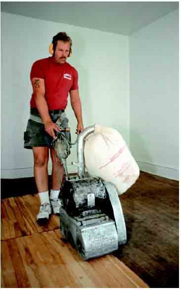

There are four main power tools required, and each one has its special function. There’s a big, heavy floor sander for removing old finish and creating a smooth, flat surface on the main floor. There’s an edger for grinding next to the wall where the big machine won’t reach. There’s a “platypus” with a long bill for sanding under radiators and the like. There’s a buffer for getting an even texture on the raw wood and for scuffing between finish coats. And, as I mentioned, you need a sharp scraper for corners and other areas that have to be hand-scraped.
Drum sanders. The drum sander most rental places carry has a big cylindrical drum with two cracks in it. You take a large sheet of sandpaper, wrap it around the drum, tuck the ends into the crack, and then turn two bolts to tighten it. The only problem is that you’ve got a perfect cylinder with a flat spot on it. Every time that crack hits the floor, it causes what’s called a chatter mark. When you look at the finished floor, you can see this repeating symmetrical pattern perpendicular to the boards.
The better choice is a model like my German-made machine, which has a main drum with a small roller up above it that takes belts. The belts are seamed together on the diagonal, so there’s no chatter mark. To change belts, you lift up a little lever that takes the tension off the roller. You slip the old belt off, slide the new one on, and you’re back in business.
Good models also have a lever for feathering the drum slowly onto the floor as you move forward. That way you don’t burn trenches into the wood every time you start and stop. Unlike the buffer, edger, and platypus, the big machines run on 220-volt power.

I also look for nails, and before I sand, I countersink them all (Figure 2). One nail can ruin a whole job. You get something called a nail run. Sometimes the nail is flush with the surface of the floor, and you don’t see it until you sand it and it shows up as a little silver line. But that nail just put a groove in your sanding paper. Now, with every run down the floor, you’ll duplicate that pattern on the floor. It makes this little raised tube on the surface of the wood; then when you stain the floor and finish it, the first screening will take the color off the top of those little raised strips. You’re at the very end of the job and strips pop up everywhere. Nail runs are scary.
But even scarier is what can happen if you run over a drywall screw, or a dime or penny that has fallen into a crack between wide boards. Part of the reason for vacuuming is to suck up those things. If a floor sander hits a screw at 2,800 rpm and that thing sparks while your bag is full of fine sawdust and you’re sucking in 1,600 cfm of air, you can get a fire in the bag. I’ve had bags blow up on me twice. I’m sanding along, and all of a sudden it smokes and boom! It just bursts into flames. That’s why I have a fire extinguisher with me at all times. I can immediately shut off the machine, leave the bag where it is, and extinguish the fire right there. I don’t carry the bag through the house, because I don’t want to set the rest of the house on fire.
