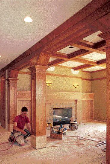

Craftsman-style wood paneling is one of the easiest types to install because the stiles and rails have no sticking profile: They’re cut square, which means you don’t need cope-and-stick router or shaper bits. And with square-cut stiles and rails, there’s no need for fancy panel molding either. The trick is to preassemble all the stile-and-rail sections and install the panels before fastening anything to the walls or columns.
We recently finished a job where we wrapped structural columns with a frame-and-panel treatment. The columns supported angled arches, which continued the paneled treatment. Fortunately, the owner wanted a collar of crown molding near the top of each column, which provided a good way to hide the joint between the column panels and the angled panels for the archways.

Wrapping the lower section of each column was the easy part of this job. We used the story pole to determine the heights of all the panels, then cut a stack of stiles and rails. The wide top rails had to be glued up because the alder boards didn’t come wide enough. Since the backs of all the panels were hidden against the columns, we were able to use pocket holes to secure the boards and didn’t have to wait for the glue joints to set up. We also used pocket holes to secure the stiles to the rails, which allowed us to move along at a pretty good clip (Figure 2).
Figure 2.Pocket screws make for tight joints between rails and stiles (top left) and allow the frames to be handled while glue is still wet. In a quick operation, a carpenter rabbets the frame (top right), then installs the panel with glue and staples. The panels were cut 1/8 inch smaller than the overall width to allow for seasonal movement.
We didn’t even wait for the glue to dry before rabbeting the back of each frame for the 1/4-inch panel. We set the panels in a small bead of glue, dropped each panel in place, and then secured it with staples.
Installation went pretty fast, too, at least on the center columns. We eased the edges of every outside corner to emphasize the joinery and provide a little wiggle room: Installing flush corners can be much more demanding. Next, we glued up the corners, holding them in place with clamps so we could adjust the fit before securing the corners and the field with finish nails (Figure 3).
