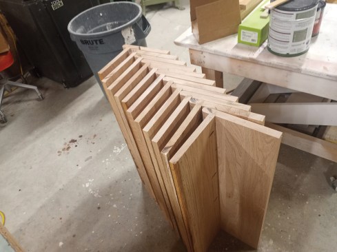

I prefer to build treads and risers in the shop, as I did for this project, but they can be built on site if space allows. I ripped the subtreads to width from a good-quality, AC-grade plywood. Because the other trades would use the framed stairs before I applied the finished treads and risers, I added subrisers for strength.
For stain-grade treads, I prefer mail-order premade treads, which I used here, from a good stair-parts manufacturer; the oak treads at the home centers are usually littered with finger joints or repetitive veneers that are applied to a poplar core. I plowed a groove just behind the nosing on the underside of the treads and cut them to their final dimensions so that the finished risers and treads would protrude beyond the stringer by a minimum of 1/8 inch per side.
I made the stain-grade risers with 4/4 boards from the lumberyard. I cut them to their final dimensions, making sure the miter saw was dialed in as close to perfect as possible to avoid accumulating errors.

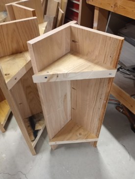

At this point in the process, I prefer to sand the treads and risers to a minimum of 180 grit, then prefinish them with stain (where applicable) and two coats of polyurethane. Once I had done that here, I preassembled the treads and risers in pairs using PL oil-based construction adhesive, followed by pocket screws and corner blocks to hold things square while the glue cured (See slideshow below). The riser fit into the groove I routed earlier on the bottom of the tread; this negated the need for a scotia/cove molding and ensured that the unit run would be exactly the same from tread to tread, even if the stringer cuts were a little bit off. I didn’t preassemble the bottom riser and tread, however, because I like to scribe them to fit at the end.

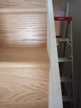

When the stairs are penned in by finished walls on both sides, I attach the skirtboard by toenailing through the underside of the nosing, which draws the skirtboard tight to the nosing. But since here I could access the sides of the stringers, I face-screwed the skirtboards directly to the end grain of the treads and risers. I used a pants jig with a backing block to mark where to place the screws (the depth of the nosing determines how thick the backing block needs to be). I traced the risers and treads onto the back of the skirtboard, then predrilled and fastened the skirtboard to the treads and risers with countersunk framing screws.
The pants jig the author created allowed him to trace out where the fasteners could be placed.
Proper placement allows for a tight fit of the skirtboard. This jig can be saved for future projects.

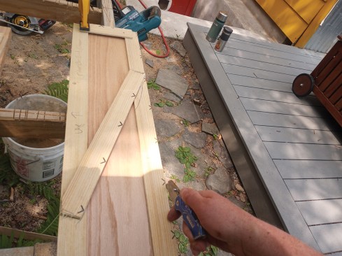

With the stairs in place and both skirtboards attached, I could scribe and attach the bottom riser, top riser, and landing tread. I templated the space for these components using strips of lauan and a hot glue gun. For the bottom riser, I scribed the lauan strip that contacted the floor and then built the rest of template to fit the space. Next, I placed the template on the finish material and traced it with a sharp utility knife. Using those lines, I cut the riser to size for a perfect fit. I repeated this process as needed with the other components.
With a lauan template placed on top of the riser, scored lines can be made to match the floor and tread.
Using the template the author creates a tight scribed fit at all the edges.
Using the template, the author creates a tight, scribed fit at all the edges.

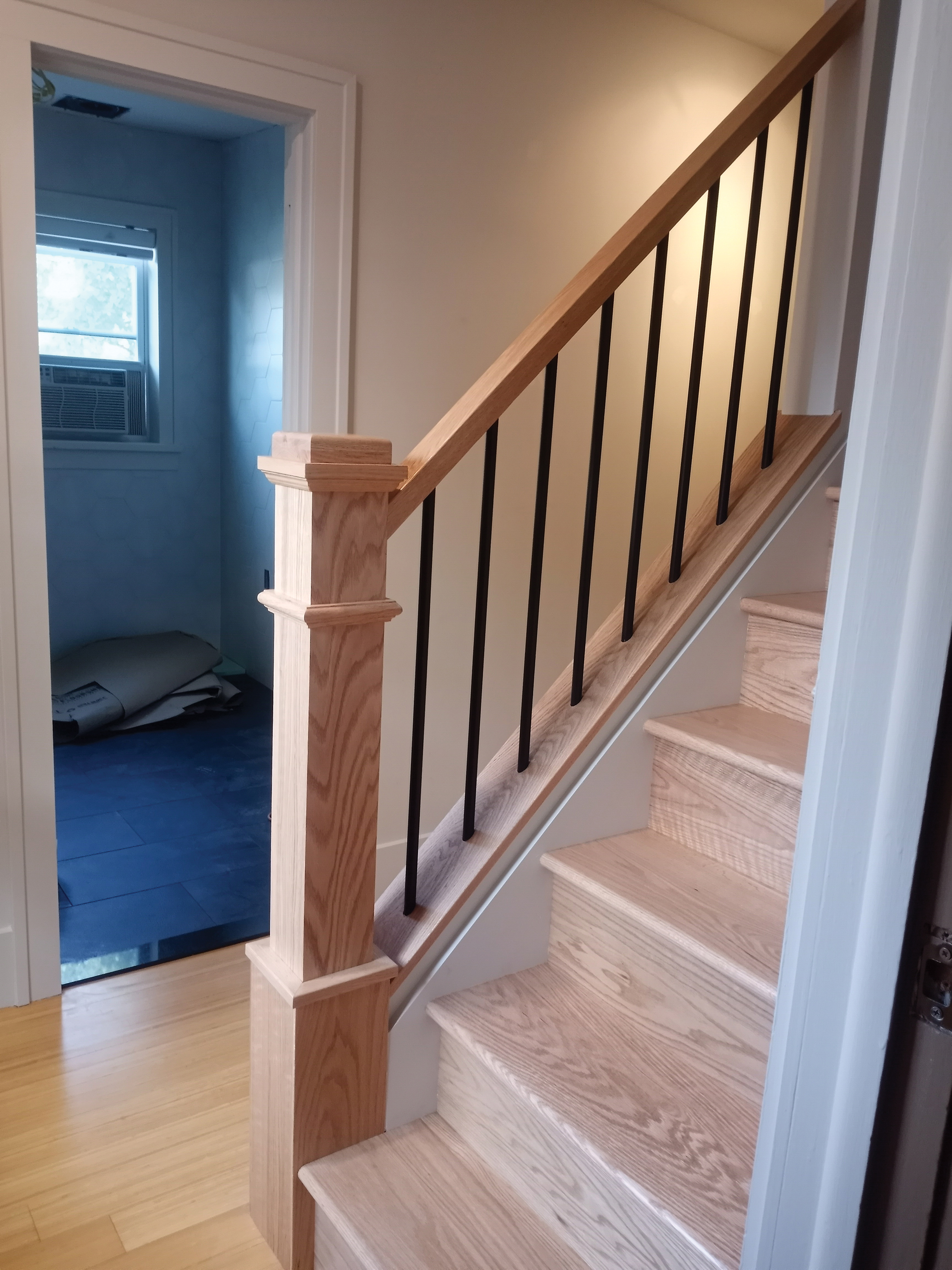

Balustrade
As with the stairs, I created a story pole for the balustrade, with lines representing the thickness of the balusters at 4 inches on-center. I clamped the story pole at an angle so the lower newel post just barely hid the first baluster mark and the upper newel post (or termination point of the balustrade such as a wall) just barely hid the upper baluster mark. Then I plumbed down from the center of the story pole baluster marks and marked the wall cap (or shoe rail).
With the story pole clamped in place, lines are plumbed to the wall cap and marked to the handrail. By templating, the author could visualize the completed product before drilling finish material.
Angle blocks and clamps kept drilling consistent for spindle installation. Drilling was done on site allowing for double checks and adjustments.

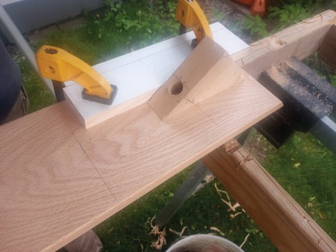

I drilled out the wall cap and underside of the handrail using angled guide blocks that I made from the stringer cutouts. After starting the holes with a hole saw, I chiseled away some of the waste in the workpiece, then finished drilling the holes with a Forstner bit. An offcut from the handrail served as a guide block for drilling the hanger-bolt hole in both the newel post and the handrail. Then it was a matter of installing the hanger bolts, toenailing the handrail to the wall, and plugging all the holes. I trimmed the plugs flush and lightly sanded the handrail before finishing it with polyurethane to complete the project.
