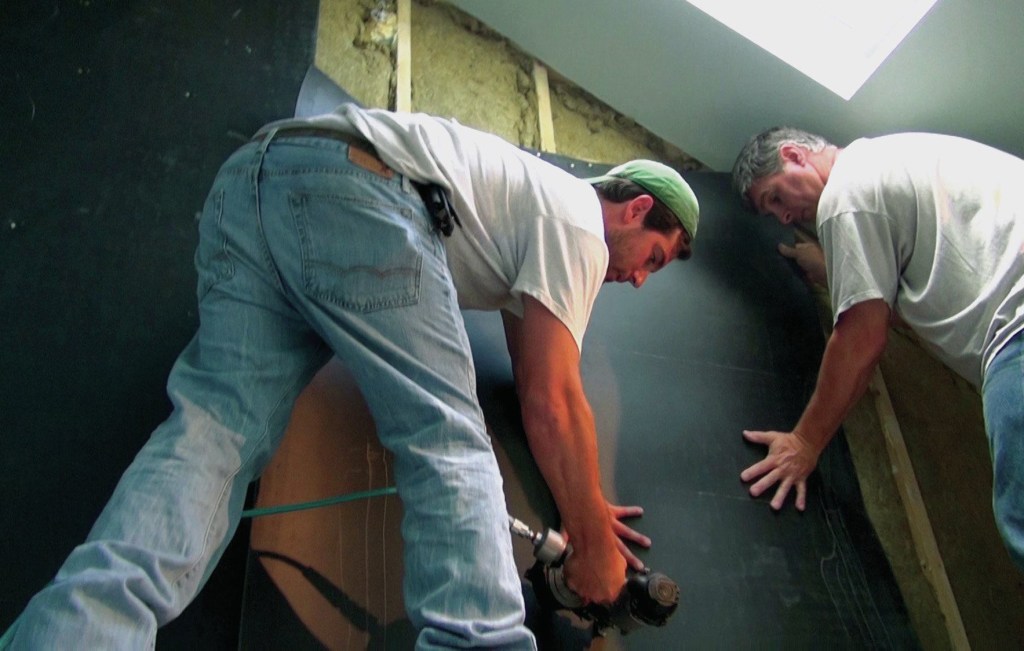

Decoupling
The most effective way to reach high STC levels is to decouple two faces of a new wall. To save space, install 2×3 studs every 8 in. between a pair of 2×4 top and bottom plates, staggering the studs to line up with alternating sides of the plates. Alternatively, use 2×4 studs with 2×6 plates, placing the studs 8 in. or 12 in. apart for 16-in. o.c. or 24-in. o.c. nailing on each side of the wall. For even higher STC ratings, build two separate walls without a common plate.
To decouple the two faces from an existing wall, use resilient channels. These are fastened horizontally to the studs and absorb sound vibrations coming from the drywall. Drywall screws should be long enough to penetrate the drywall and the channel, but not long enough to reach the stud.
