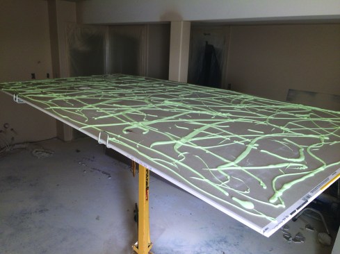

He hung a second layer of ceiling drywall, using two quartsize tubes of Green Glue per sheet. The product is not an adhesive but a sound-absorbing layer that evens out to a 1/8-inch-thick layer when the second sheet of drywall is pressed into place with a drywall lift.

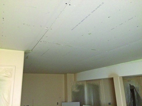

In a basement ceiling, if you can get all the wires, pipes, and ductwork above the bottom edge of the joists, two layers of drywall is an easy retrofit for sound control.

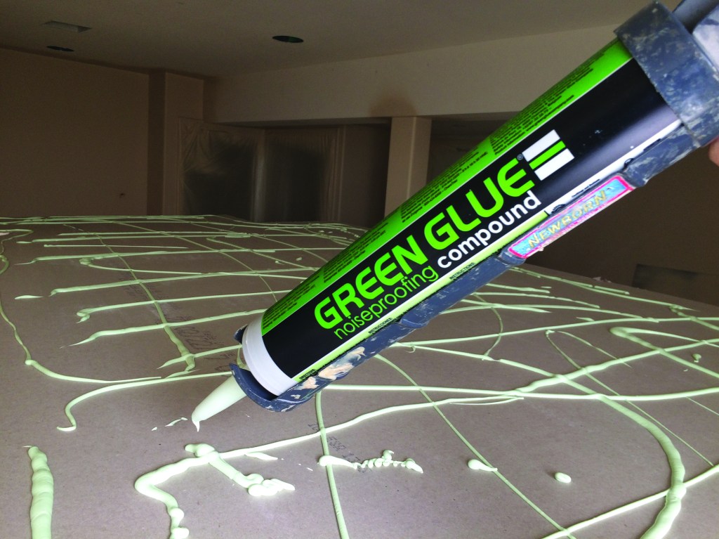

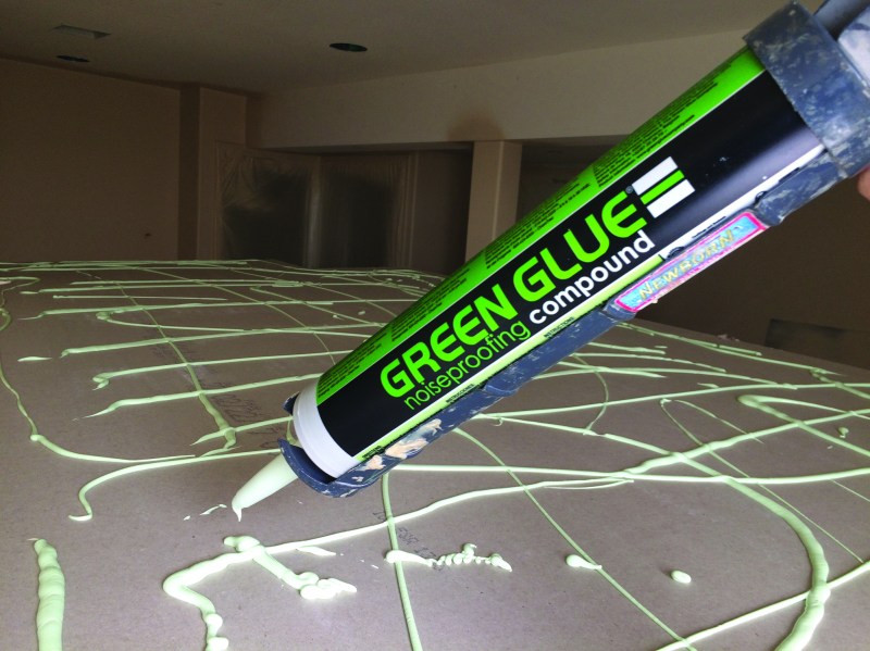

According to the manufacturer’s instructions, Green Glue should be applied in a random, squiggly pattern on each sheet of drywall. It takes approximately two tubes of glue per 4×8 sheet of drywall. The glue is sticky, and following the instructions, I tried to keep it back from the perimeter of the board to minimize the amount that oozed out around the edges when the sheet was hung. The glue did not run much and stayed where I placed it. When I cranked the sheet up against the ceiling with the lift, I used twice as many screws as I usually do, following the manufacturer’s instructions to fasten every 12 inches on-center for ceilings. The glue is not really functioning as an adhesive, but as a vibration-absorbing substance.

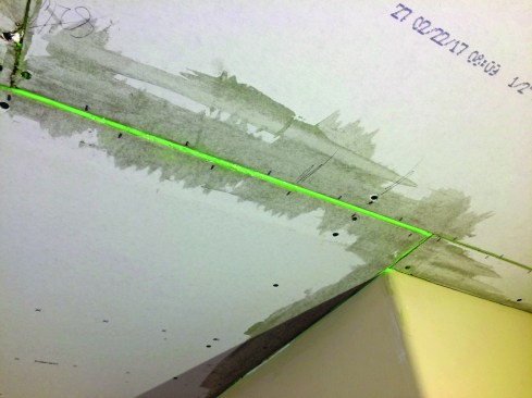

As each sheet was hung, a bit of glue squeezed through the outer edges. According to the manufacturer, the compressed glue results in a layer a little thicker than 1/8 inch, or 0.5mm, between the sheets. The manufacturer recommends using a product called Green Glue Sealant to fill gaps. I hadn’t ordered any, so I used the same Green Glue to fill in the gaps around the perimeter and any gaps in the field. Here, the glue kept wanting to ooze out, and I used my putty knife to trowel it up tight until it set up and stayed. (I imagine the sealant designed for this purpose would have oozed less.)
Gaps can be filled with a thick bead of Green Glue.

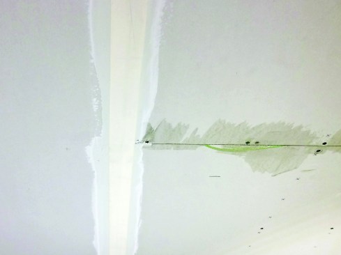

It gets messy and you want to scrape it off the face so it won’t affect drywall finishing.
I also had to make sure any extra glue that had oozed between the joints was scraped off so that the drywall mud could bond. The next day, when I went to place the first coat of mud, some of the glue had started to sag around the edges, so I pushed it back into place and quickly taped and mudded the joints. Because of adding a second layer of drywall, I couldn’t use products like Rock Splicers to help create recessed butt joints. Instead, I coated the butt joints with a wider swath of mud to create as flat a finish as possible.
When we painted the ceiling, we found a couple of spots of Green Glue that had been accidentally left on the surface. I had to rub and sand all these areas as thoroughly as possible; otherwise, paint would not adhere on them.
After all was done, I was relieved it seemed to work effectively. When someone was talking or walking upstairs, I could still hear sound and voices, but I couldn’t make out what they were saying. In retrospect, I realized some of the sound was coming through the ventilation ductwork. Having the basement on a separate heating and cooling zone with no shared ductwork would have also helped to prevent sound travel between floors.
