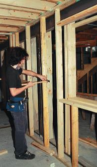

Parallel 2x4 partition walls provide acoustic separation between rooms. To reduce sound transmission to the living space above, the author dropped separate 2x10 ceiling joists below the plane of the I-joist floor system.

As a first step, we framed the partitions as double walls. Rather than staggering the studs and using common 2×6 plates — which would transmit sound — we used two separate 2×4 walls, floor to ceiling. To further isolate the wall from the slab and the ceiling joists, I installed Integrity Gasket (Shadwell Co., 800/494-4148, integritygasket.com), a 1/8-inch-thick closed-cell self-adhesive PVC tape, under the sill plates and on top of the top plates.

The first floor of the house was framed with I-joists. Over the band room, I added separate 2×10 ceiling joists in the middle of every bay, notching them at the top plate to drop the ceiling plane below the bottom of the I-joists — which effectively isolated the band-room ceiling from the floor structure above. Again, I used gaskets between the joists and the top plates. The ceiling joists aren’t fastened to the plates, but are held in place by gravity; flat 2×4 blocks nailed between the joists keep them from tipping and eliminate a mechanical connection between the band room’s ceiling and the living room floor.
