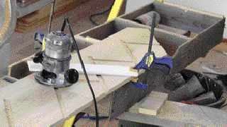

Next I use a Forstner bit and drill guide (www.rocklerpro.com) to drill a flat-bottomed hole where the tread noses will land, then rout the dadoes for treads and risers. I make the holes and dadoes 1/4 to 5/16 inch deep, and about 1/16 inch wider than the tread and riser stock so that everything fits together easily.
Using my basic router, I have to take two passes with a 1/2-inch straight bit to get the desired depth, and two more passes to get the right width. On an enclosed stair, one of the skirtboards has to be “gutted” — that is, the material behind the dadoes has to be removed all the way to the bottom edge. This allows that skirtboard to slide along the wall and into the finish treads and risers that have already been loosely installed into the dadoes on the other skirtboard.
