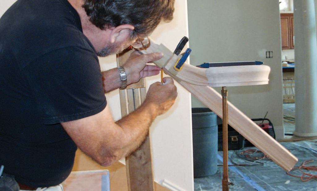

Installing Handrails
Newel placement. The bottom newel works best on the second step, rather than the first. Place it where it will catch the front overhang of the second tread, plus a slight reveal, as shown below. To find the side-to-side location, work off the centerline of the handrail.
Newel width. Traditionally, the tread nosing dies into the newel posts. For this to work out, the newel posts must be wide enough to catch the nosing. However, many readily available newel posts are not wide enough to notch solidly into position. Consider using a wider newel post style. The minimum width of newels should equal half of the baluster width plus the tread overhang plus an optional reveal — times two.
Newel length. To determine the length of a bottom newel, carry the line of the top of the handrail across to the front side of the newel to a point exactly over the nose of the second tread (below). This should be slightly in from the newel edge to allow the nosing to die into the newel with a slight reveal.
A landing newel is a little bit different — it has a longer top block that allows it to pick up both the landing rail (at a height of 36 in.) and the rake rail (at 32 in.). See below.
Newel attachment. For maximum strength, notch newel posts into the stair carriage, as shown in figures Laying Out the Bottom Newel and Bottom Newel, above, before securing with lag bolts.
Lags hold better in hardwood than in softwood, so always lag through the framing into the hardwood newel rather than vice-versa. Large washers or hardwood blocks prevent the lag head from crushing the wood fibers in the joist and loosening the newel.
Handrail and baluster attachment. For attaching balusters to the treads, all of the manufacturers of stair parts provide some type of dowel screw — a screw that has a lag-type thread on both ends (below). With these, it’s usually necessary to predrill holes in both the treads and balusters. Some manufacturers predrill the balusters.
