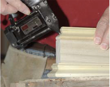

Finally, I build a detailed apron by wrapping the two long edges of a 1×3 with a decorative molding. For this window, I used stock panel molding, but any base cap or similar molding that has a square shoulder would also work.
Building up a three-piece molding is a lot more work than using the standard piece of casing as the apron. By the time you’ve completed the last return of panel molding, you’ve actually cut and assembled seven pieces, including the four mitered returns. But I’ve found that just about everything in construction that looks better requires a little extra work.
The 1x3 apron is wrapped with panel molding top and bottom.
The 1×3 apron is wrapped with panel molding top and bottom.

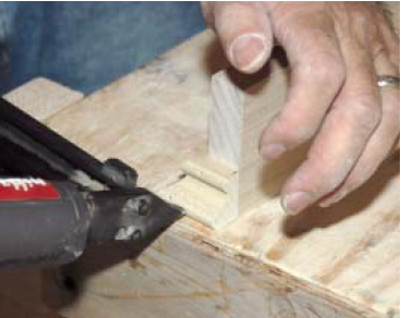

The author glues  and pins the small  pieces together with  a 23-gauge headless  pinner.

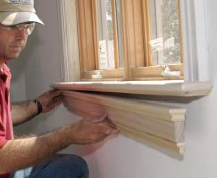

Then  he installs the apron in one  piece.
To find the length of the 1×3 apron, I measure across the window from outside to outside of the casing and subtract 1 1/2 inches to allow for the two 3/4-inch-thick molding returns. After cutting the 1×3 to length, I typically glue and nail in place the panel molding pieces that wrap the top and bottom of the apron. I use a 23-gauge headless pinner for this because it won’t split the short return pieces of molding, and it leaves small holes that are easily filled.
The last step is nailing the apron assembly under the stool. I take care to center it accurately, using centerline measurements marked on both the apron and the drywall, since any offset will appear visually exaggerated by the built-up trim. If I have done everything right, the outside edges of the panel mold returns should line up with the outside of the casing trim.
