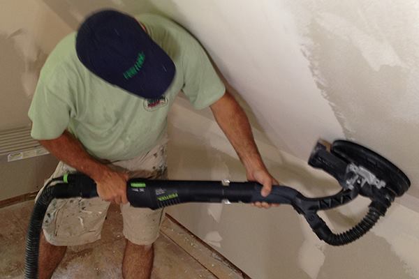

Planex in shortened 2 piece form

It’s modular
The Planex travels in a larger than average systainer that is well padded to house the essential three sections that easily snap together to form the basic configuration of the tool. The middle section can be removed to shorten the tool for use in tighter quarters. In it’s full three piece setup, the Planex can be comfortably used on up to 8 foot ceilings. For higher ceilings, Festool also offers a harness which makes overhead work physically much easier. For extended wall sanding, we found it best to run the Planex without the middle section.
