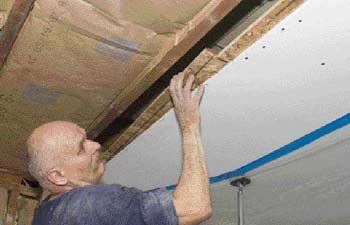

To use this tool, you have to treat the butt joint differently during the hanging process. Here's how I handle a typical remodeling job, where new drywall has to be blended into existing.
First, I cut back the existing joint so that the new edge lands in the middle of the joist bay. Next, I screw a 4-inch-wide rip of 1/2-inch or 3/4-inch OSB or plywood to the back of the existing piece for the length of the joint, then overlap the second sheet onto the OSB backer and screw it in place.
