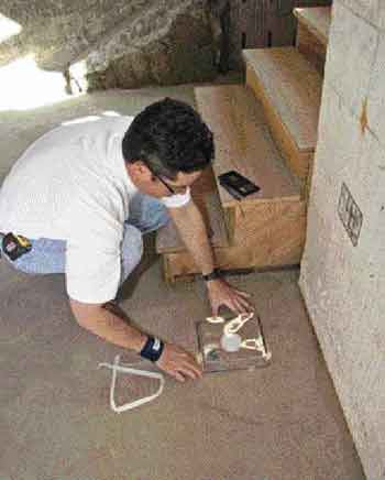

Calcium Chloride Test
I prefer to use the calcium chloride test, which is referred to in flooring specs as ASTM F 1869-04, “Standard Test Method for Measuring Moisture Vapor Emission Rate of Concrete Subfloor Using Anhydrous Calcium Chloride.” This test measures the moisture vapor emission rate (MVER), or the rate at which water vapor is coming out through the surface of the slab.
I like the calcium chloride test because it works with both new and existing slabs and doesn’t damage the surface or require expensive equipment.
How it works. The calcium chloride test is performed by placing an open container of dry anhydrous calcium chloride (a white granular material) on the slab, covering it with an airtight dome, and then, after a specified period of time, comparing the calcium chloride’s before and after weight.
If moisture was present in the slab, some of it will have escaped into the dome and been absorbed by the calcium chloride, making it heavier. The MVER is calculated by plugging this weight gain into a formula. Once I have the MVER, I can determine whether I need to take corrective action before installing the floor.
What it costs. If you were a chemist you could put the test together on your own, but for the rest of us, purchasing a commercially made testing kit makes more sense. A kit consists of a shallow dish (like a petri dish), a premeasured quantity of calcium chloride, and a dome that can be sealed to the slab. Individual kits cost about $12 apiece and can be purchased online or at any flooring distributor. A number of companies make these test kits (see list), but I’m most familiar with the ones made by Vaprecision; its kits are in the photos used in this story.
In addition to the test kits, you will need a scale that reads accurately down to one-tenth of a gram. Vaprecision sells one for $125, but less expensive models are available elsewhere.
Performing the Test
To comply with ASTM F 1869-04, you must perform a minimum of three tests for the first 1,000 square feet of slab and an additional one for every 1,000 square feet after that. Be sure when doing multiple tests that you hit the areas you suspect of harboring excess moisture.
Before any testing is done, the surrounding room must be brought to the temperature and relative humidity that will exist when the building is occupied. These conditions must be achieved at least 48 hours before testing and must be maintained while the test is under way. Otherwise the results will not be accurate.
The areas of the slab that are to be tested must be clean, so if adhesives, sealers, or patching materials are present, scrape or grind them away.
When the slab is clean, weigh the prepackaged container of calcium chloride and record this “starting weight” on the form provided by the manufacturer. Then unseal the container by peeling off the tape; open it; and place the container, its top, and the tape on the prepared section of slab. Cover them with the provided plastic dome.
The dome must be tightly sealed to the surface — nothing should be able to enter it except through the concrete. The dome (or domes, if you’re doing more than one test) should be left in place for the specified period of time; Vaprecision recommends 60 to 72 hours.
When it’s time, remove the dome and reweigh all three items: the container, its top, and the original piece of sealing tape. This will be the “ending weight.” Be sure to use the same scale that you used to measure the starting weight.
The ending weight will be slightly higher than the starting weight because the calcium chloride will have absorbed any moisture that was present in the dome and any moisture vapor that entered through the slab. To calculate the MVER, you take the difference between the starting and ending weight and insert it into the formula provided by the manufacturer of the test. The result will be the number of pounds of vapor emitted per 1,000 square feet of slab per 24 hours.
