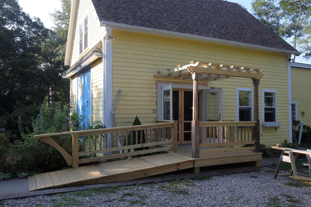

In 2010 I put in new, more weather-tight outswing French doors, as well as a fancier entry with equipment ramp and pergola.

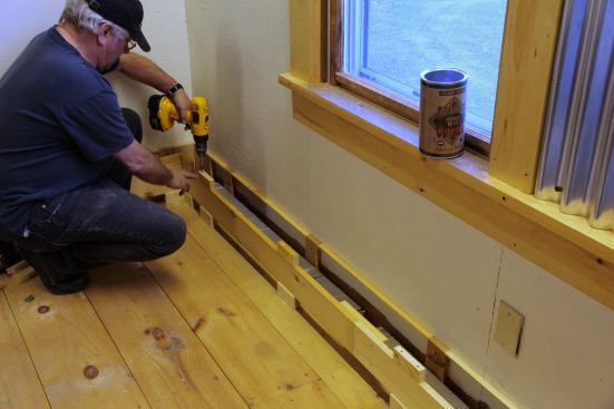

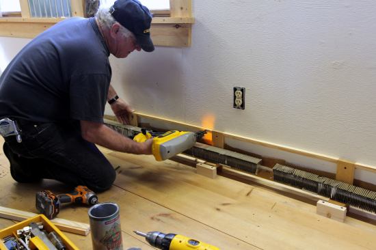

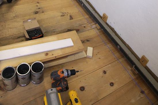

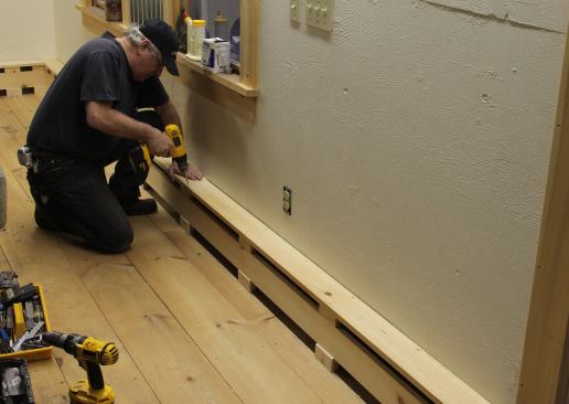

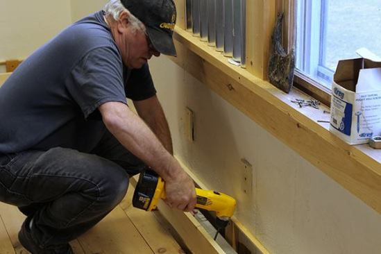

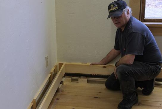

Which brings us to the present and the real topic of this blog: As of last Sunday morning the bare heating element was still perched on those funky brackets I’d installed years before. I’d decided early on to make custom wooden covers, but didn’t finalize the design until the end of last year. In the name of speed and my established “rustic barn aesthetic” (read: quick and dirty finish work), my design combined stock 1×5 boards with simple ripped blocks to create the ventilated enclosure. Randy Patterson, a musician buddy of mine who does remodeling, came to help me with the install last Sunday.
I had all the materials ready and moved stuff like my orange and bay laurel trees away from the wall to give us room to work. Randy pulled up in his old Toyota pick-up at around ten. By four o’ clock the enclosures were done except for a light sanding and the band molding that will cover the gaps from the wavy walls (see slide show of the process). In keeping with the unrefined décor, I will keep the #2 pine natural and unfinished and we made all visible attachments with exposed finish-head screws. I’m hoping that our efforts will appear in an On the Job piece for JLC in the near future, not as a lesson in fine finish carpentry, but more as a strategy for building custom hydronic baseboard covers, that could be modified or adapted to any level of finish to fit any type of décor.
