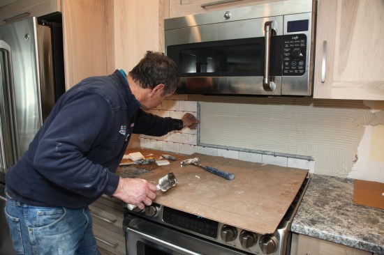

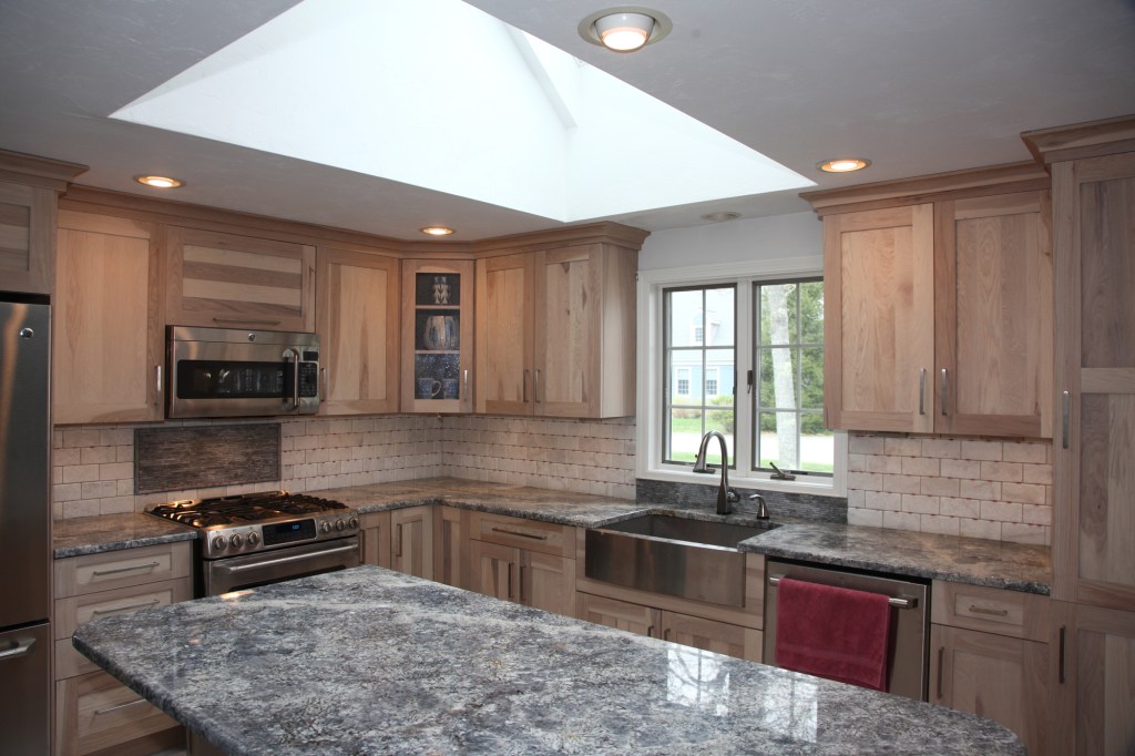

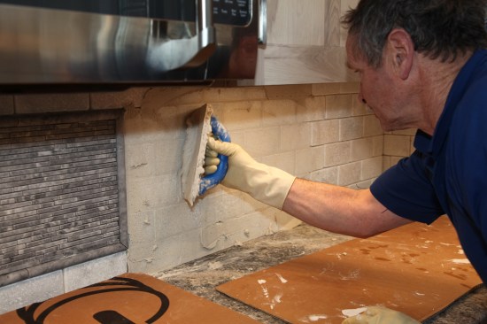

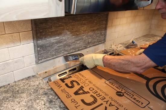

Nothing can put a new kitchen over the top like a tiled backsplash. After bathrooms and tiled floors, it’s one of the most common tile jobs that I do.

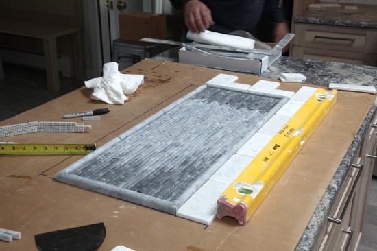

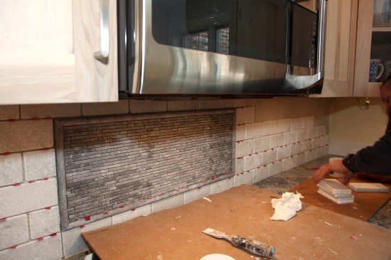

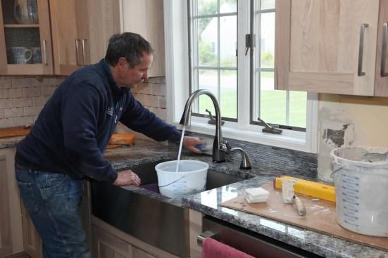

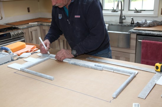

During a recent remodel that included opening up their kitchen and dining room, clients replaced their old cabinets with Craftsman-style bleached oak and their old countertops with beautifully figured black and white granite. For the space between the countertop and upper cabinets, they chose tumbled marble subway tile, with a framed mural of horizontal mosaics over the stove. They also wanted the same mosaic tile installed under the window behind the sink.

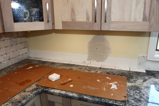

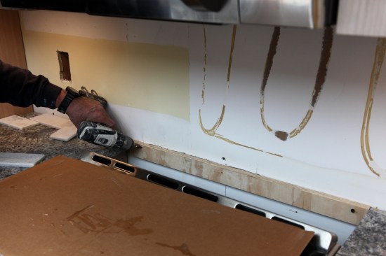

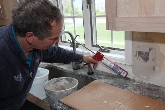

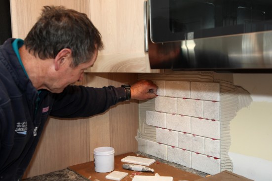

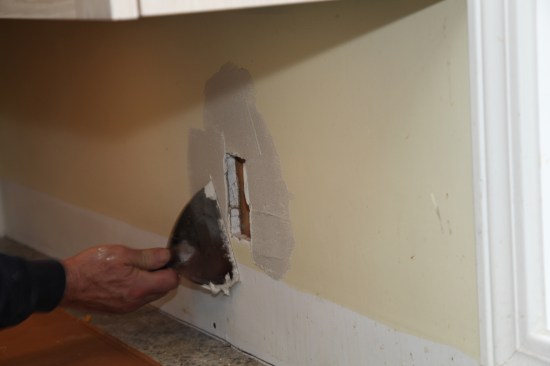

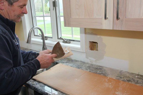

Knowing that with proper prep-work a tiled backsplash installation usually goes smoothly and quickly, I started there. In this kitchen, part of the prep was patching old outlet holes, left in the wall when the outlets were relocated to strips below the upper cabinets. With that small task completed, I was ready to roll.
