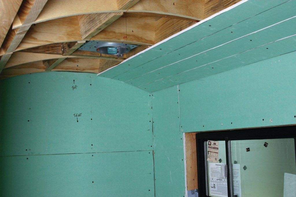

To shed water properly, bathroom ceilings should never be flat. Here the ceiling is arched and a tight grid has been framed to support the tile. Strips of green board form the initial arched surface.

Another important part of tiling a ceiling is providing solid support for the tile. For any of these designs, I begin with framing members spaced 12 inches apart. For an arched ceiling, I make curved joists out of 3/4-inch plywood. Then I block between the arches to create a very strong framing grid. I never recommend applying tile directly to greenboard, but I use strips of greenboard attached to the arched framing as a support base for the mortar setting bed (see photo above). I spread a layer of cold-patch roofing tar over the greenboard strips and then staple a layer of 30-pound felt paper over that.
An alternative to greenboard is two layers of 1/4-inch cement backerboard screwed into the joists. Attach the backerboard one layer at a time, applying thinset mortar between the layers for added strength and stiffness.
When I did the ceiling in the photos, I let the roofing tar create my moisture barrier; for extra protection, sheet-style waterproofing membrane such as Noble Seal TS can be installed between the mortar bed and the support base, or between the framing and the first layer of backerboard.

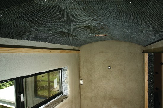

To waterproof the ceiling, a layer of cold-patch tar is spread over the green board followed by a layer of 30-pound felt paper. Wire mesh is then nailed in over the entire surface.

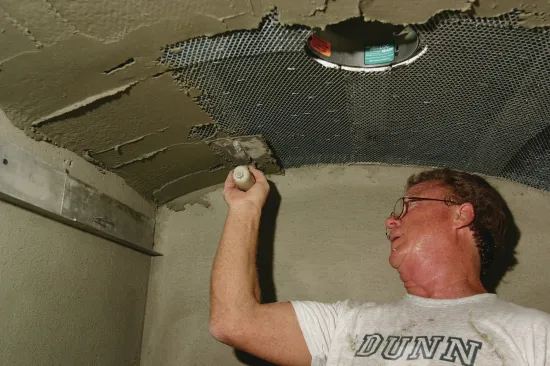

A layer of mortar is smoothed  onto the wire mesh with a trowel. When the mortar dries, the tile installs over the mortar with thinset.
I then attach wire mesh to the ceiling (photo left) and trowel on a layer of mortar for the setting bed, smoothing the curve with a flat trowel as I go (photo right). Finally, I use regular latex-modified thinset and back-butter all ceiling tiles as they go in. Surface tension holds the tiles in place until the mortar cures. When tiling a sloped or curved ceiling, begin at the lowest points and tile toward the highest point. Use spacers as needed to keep the tiles from sliding, which can break the surface tension and cause the tiles to fall.
