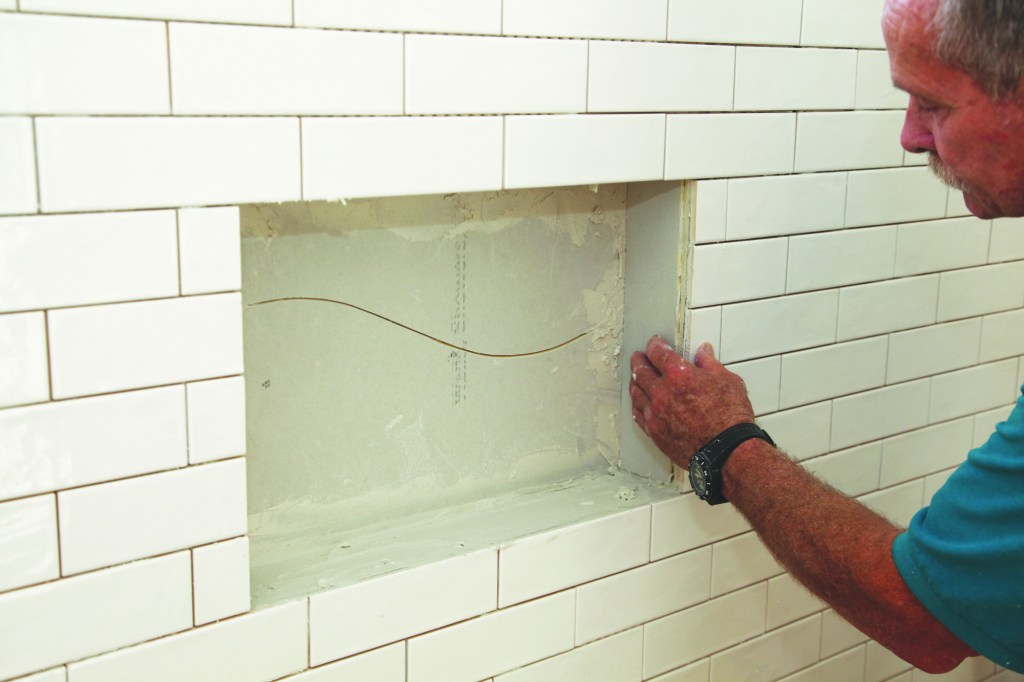

To waterproof a tiled niche, apply waterproof backerboard to the inside surfaces of the niche. (The back wall of this niche
was in two pieces to facilitate installation.)
To waterproof a tiled niche, apply waterproof backerboard to the inside surfaces of the niche. (The back wall of this niche was in two pieces to facilitate installation.)

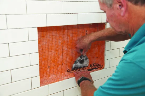

Next, apply waterproof membrane, bedding it in unmodified thinset.
Although I have installed manufactured niches, I most often custom-make niches to fit in specific places in a shower. In the project I wrote about in “Tiling a Walk-In Shower” (Nov/19), we lined up a niche below the window in the shower. I first lined the inside of the niche with waterproof Johns Manville GoBoard backerboard (the same board that we installed in the rest of the shower), bedding it in modified thinset. Then I cut and installed a layer of Schluter’s Kerdi waterproofing membrane. At that point, the niche was essentially waterproof, so it didn’t matter that I used two pieces of stone tile to cover the bottom of the niche.

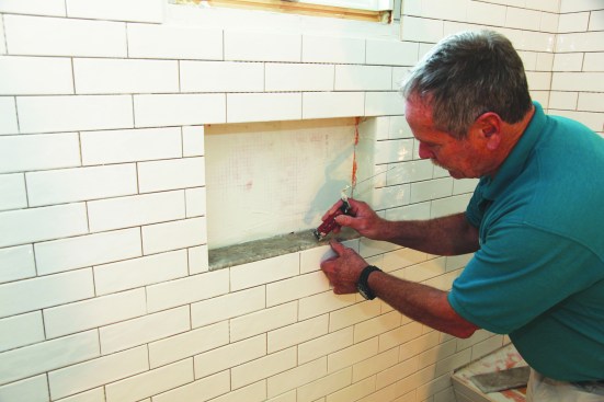

With the waterproofing complete, install the tile starting with the bottom of the niche, which should have a slight pitch for drainage.
That said, there are a few key points that I always try to address when installing shower niches. First, I encourage clients to locate the niche on a wall that receives a minimal amount of direct water from the shower. After waterproofing the niche, I install the bottom pieces with a slight pitch so that the water runs out and doesn’t pool in the niche. Also, if using porous tile (such as the limestone for this niche), I make sure that the tile is sealed properly before the clients use the shower.
