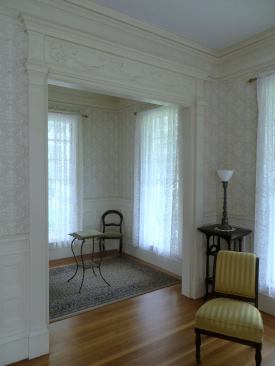

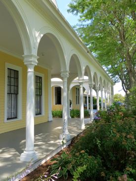

The Crosby Mansion would hardly qualify as a “mansion” in most parts of the country, but in the sleepy rural town of Brewster, it was and still is one of the most magnificent buildings in the town. (For more on the history of Crosby Mansion, go to http://www.crosbymansion.com/. ) I’d driven by the place dozens of times in the 10 years I’ve lived on the Cape Cod, and have always been curious to see what was behind the spindly-pillared porches that line the front of this grand building nestled in the woods of the Cape (photo 1).

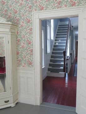

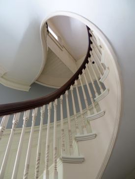

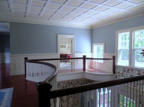

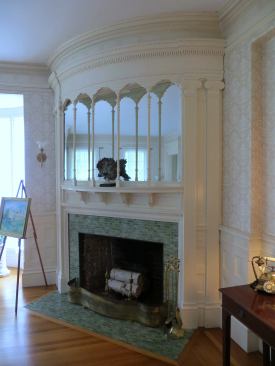

To be honest and fair the house was not meant to reflect or follow a particular style. The open entry foyer festooned with curved balustrades was supposed to evoke feelings of Buckingham Palace—a stretch of the imagination at best (photo 2). A room off the entry has a highly ornate floor-to-ceiling mirrored fireplace reminiscent of one at the Palace of Versailles—again supposedly (photo 3). And off that room is the billiard room that felt more (to me) like it belonged in an English country estate (photo 4). The trim and ornamentation in these rooms were as varied as the rooms themselves.

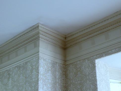

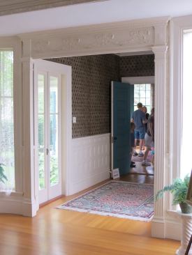

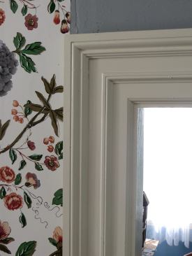

In the Versailles room, one doorway was framed with square columns topped with an elaborate entablature (photo 5). In another doorway in the room, the columns became casing (photo 6), (which in those days would probably have been known as architrave molding). The trim around the ceilings (that I believe is also called entablature—Gary, correct me if I’m wrong) was also elaborate with multiple layers of crown molding, an ornate frieze and picture-hanging molding (photo 7). It must have been a fun carpentry project!

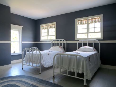

But Gary’s article delves particularly into casing, and these details really piqued my curiosity. Outside of the most ornate rooms in the house, window and door casing seemed to vary quite a bit. In these “public” rooms of the house, windows were cased in a classic profile with a backband, descending fillets and mitered corners (Photo 8). On the second floor the openings around the Buckingham balcony used the same detail. But in the bedrooms and hallways just off the balcony area, the predominant casing had rosettes in the top corners with continuous backband around the rosettes (Photo 9). In some doorways the casing sat on plinth blocks, while in others the casing ran all the way to the floor. Oddly enough the casing in the large walk-in closets was a mitered detail that resembled the public areas of the first floor (Photo 10).
