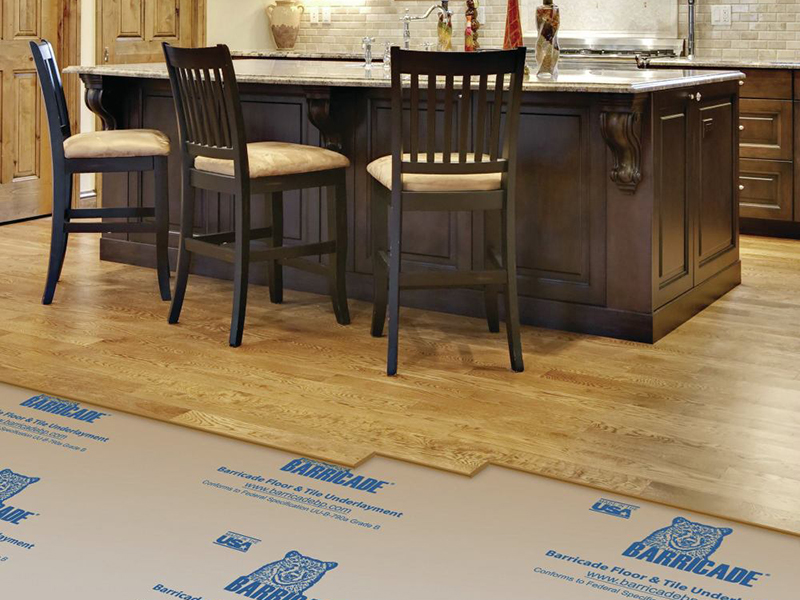

Most wood finish flooring installed in the past 150 years has had some sort of paper underlayment installed between the subfloor and the finish material. Not always, but most of the time.
Very often it was/is rosin paper. Very often it was felt paper – not so much anymore since oil became evil. These days we have a variety of newfangled, expensive papers.
There is no great reason for putting paper beneath wood floors if you’re building to modern standards – modern enclosure standards. You can skip the paper and be totally fine. In fact, if it’s a wide plank floor that needs to be glued down you can’t install paper. But it’s still commonly used and if you speak with builders or wood flooring installers or architects, you hear all sorts of reasons for the purpose of this paper:

Having said that, there are some reasonably good reasons for it. First, and, in my opinion, most significant, it makes the flooring installation easier for the installer. That’s not a real reason to specify it, but it is a good reason to allow contractors to use it. Those new floorboards slide around much easier on the smooth paper rather than the rough subfloor. More productivity, that’s a good thing. Second, it does reduce dust – the dust on the subfloor that’s been getting ground in over the past months during the construction process is now trapped there. That’s a good thing and probably enough of a reason to specify it’s use.
Unfortunately, some of the reason’s you’ll hear for its use are partial or complete BS. One of the most common is that it prevents floor squeaks. Not so much. Most floor squeaks result from two side-by-side boards rubbing up against each other. Paper below the finish material isn’t going to solve that problem. The second most common cause is one board moving against a nail. Paper underlayment is no help there. Way down the list of reasons is floorboards moving horizontally against the subfloor. I’m not saying that never happens, it does, but not so much. The squeak thing is BS.
