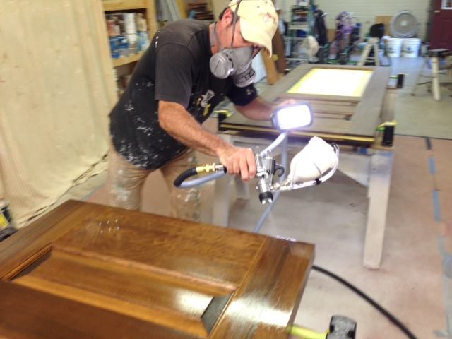

Todd applies clear finish on gel stained custom fir doors.

Todd and I frequently team up on wood restoration projects of all flavors – interior and exterior. Sometimes we are presented with antique quality pieces to work with. If clear finish is involved, the project always falls into the category of “fine finishing”, a rather misunderstood term these days. So, we are sharing some of our own wood finishing tips to help bring clarity to clears.

Tips for Overcoming Fear of Finishing
  • During the build phase, save all cutoffs (called “drops”)
  • Sand the drops to the same prep level as your finished piece
  • Prep sanding grit level is determined by finish to be applied
  • Finish to be applied is determined by the desired look, color tone, sheen
  • Use the prepped drops as finish samples
  • Arrive at your exact finish sequence on the samples before going “live”
  • Take careful notes, commit nothing to memory
  • Notes include material reduction, HVLP settings and tip selections
  • Observe the spraying pace and distance from target that produces the best results
  • When you spray the actual piece, do it in a controlled environment (not outdoors)
  • When done, clean your sprayer in a different area than your finish/drying space
  • Walk away. You are nothing but a contamination risk at this point.
