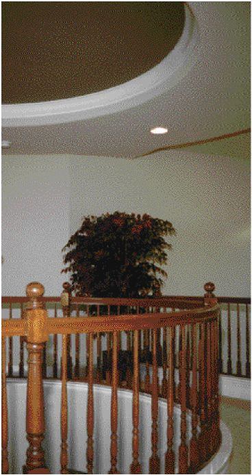

It's a good thing I like working with crown, because installing crown molding on curved surfaces has proven to be a big challenge. I recently finished a small task where the framer didn't follow the plans and the millwork salesman's measurement of the subsequent "custom" work -- an oval ceiling soffit -- was off just enough to create a problem. It turned out that I was trying to work with material made to a radius of 1 1/2 inches less than I needed. As I attempted to position the crown along the wall, the top edge would pull away from the ceiling. By the time the new material arrived, installation seemed easy. The lesson is that flexible crown is not very forgiving and must be ordered accurately. Because we work in production housing, ordering in advance from the plans is a necessary part of the process. As long as everyone builds to the plans, there's no need to field-measure, but double-checking can prevent time-consuming and expensive mistakes.
The radii on the plans we get are called out as a rough measure, so we compensate for drywall thickness to make our orders more accurate. The drywallers in our area bend two layers of 1/4-inch gypsum board to make the curves, so adjusting the radius 1/2 inch makes the pieces fit better. It's important to remember that you subtract 1/2 inch for inside curves, but add 1/2 inch for outside curves.
Flexible crown molding can be manufactured with an irregular radius (as in ovals and ellipses, for example), and the profile can be oriented upside down from standard if desired. But irregular radii will require a template or drawing, and upside-down profiles require special instructions on the supplier's order sheet.
