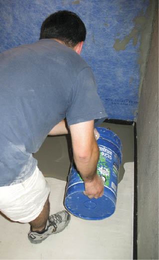

The trick with any SLU is to get all of the material in at the same time. That's because there's a limited "self-healing" period once the material is mixed with water, typically about 30 minutes. Within this time, different buckets of material will flow and merge together, but once the half-hour is up the material starts to clump and skin over, then quickly sets up and becomes unworkable. We've learned the hard way that you don't want to still be working the material after it starts to go, so we make sure to stage the job carefully and work quickly.
Mixing. There's no need to guess how much water to use or what the proper consistency should be. Each manufacturer specifies the exact mix ratio, which we follow precisely. For example, a 55-pound bag of Laticrete 86 requires 6 quarts of clean water. When we're ready to pour, we measure out the water needed for each bag in advance and dump it into a bucket. We make sure to have a bucket ready for each bag that we need (Figure 6). If there are any lumps of material in the bag or if the bag is more than about six months old, we won't use it.
Figure 6. An exact amount of water is dumped into the bucket, and then a bag of powder. Each bag gets its own bucket, and is mixed for two minutes with a 1/2-inch drill equipped with a special mixing paddle.
A 5-gallon bucket holds one bag of material plus water, but just barely. To give us a little extra room for mixing, we use the less-common 6-gallon buckets that some of the other tiling products are packaged in. After we dump in the powder, we mix each bucket for two minutes with a drill-mounted mixing blade, then quickly move on to the next bucket. Hot water will accelerate the cure, so we always try to use room-temperature or cooler water. For bigger jobs, we make sure to have several paddle-equipped drills on hand.
Once we've mixed the underlayment we plan to use, we give each bucket another quick mix before pouring it onto the floor. We fill the lowest points first, then work toward the high points, using our screws or pillars as guides (Figure 7). If we have to move material around, we use a rake or a spreader. A flat trowel is handy for areas where we have to feather-edge the material.
Figure 7. Starting with the low spots, all of the buckets of SLU are poured onto the floor (A). To move material around, the crew uses a flat trowel-like spreading tool (B), a standard garden rake (C), and a gauge rake with adjustable wire sleds (D).
