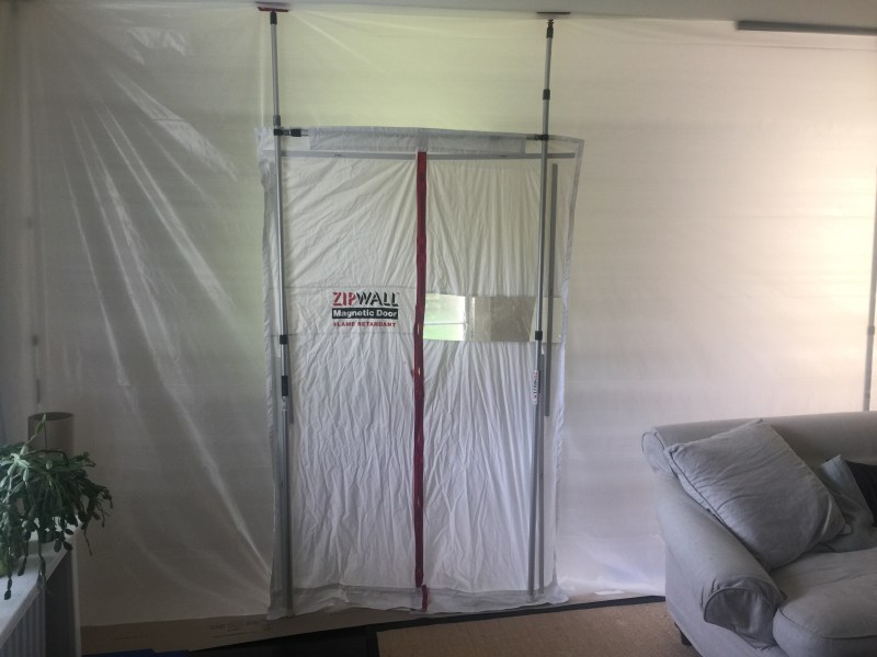

Magnetic Door Setup
Setup happens between two ZipWall poles that are placed on the inside of your barrier wherever you need your access point. With the poles in place, you start by clipping in the header bar, and then securing the two-piece magnetic strips to the side and top. These strips make a tight connection between the plastic and door that dust can’t migrate through. Once that is done, cut the plastic from the inside, which exposes the door panel – and then cut away the excess plastic. The door panel itself is made of high-tech fabric that is flame retardant and features a clear plastic window, so you can see if anyone is on the other side before you walk through.
In lieu of a zipper, the door has self-closing magnets that are sewn into the fabric. When you need to go in or out, simply push against the center of the door panel where the magnets are, which allows the center of the fabric door to separate. Once you are through, the magnets pull the fabric door closed behind you. No need to set anything down. I was actually amazed at how easily the magnets centered themselves and closed automatically.
While in general it is easy to set up, I recommend watching the video tutorial (below). On the positive side, it is a great improvement to a very useful dust control system. Although I won’t label this as negative, it works best when you have a nice straight area as your access point. It won’t work well with any kind of curve. And if the need for dust control is frequent, then the retail price of $270 (not including the poles) will be worth it.
