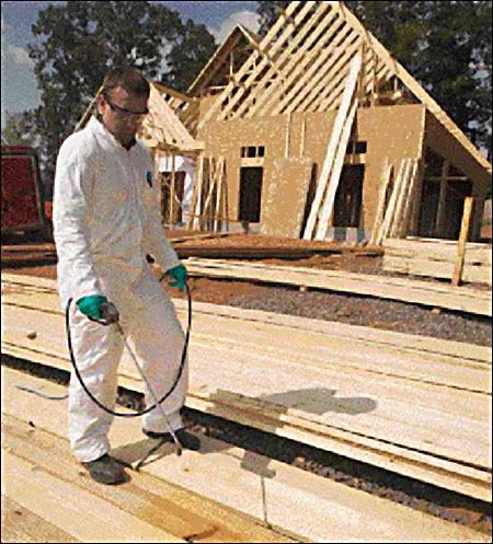

Borates applied to wood framing (above) provide one of the most effective treatments against the super-aggressive Formosan termite. Pretreated lumber is available, but typically a pest-control specialist must spray all the framing and sheathing with a borate solution at the “dried-in” stage of construction.

Spray-applied borates. More commonly, untreated wood is used for framing, and a pest-control specialist arrives with a small crew at the dried-in stage and before drywall to treat the job site in one evening. Tim-bor and and Bora-Care, both distributed by Nisus Corp. (100 Nisus Dr., Rockford, TN 37853; 800-264-0870; www.nisuscorp.com), are the most common materials for these spraying applications.
Borates penetrate wood well and, applied in suitable concentrations, should be effective for at least 20 years. Treatment at the job site requires that all wood/cellulose products be sprayed, including all framing and flooring. The cost of borate treatments averages $1 to $2 per square foot of floor space.
