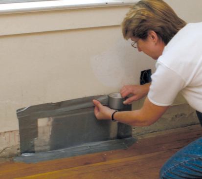

6-mil poly and duct tape. If I'm lucky, the containment process might be as simple as locking an interior door and duct-taping its edges, or covering an open passageway with 6-mil plastic sheeting and sealing all four sides with duct tape. For larger projects or houses with open floor plans, I may have to erect a temporary partition wall and wrap it with a membrane of 6-mil poly. (For more information about erecting an effective dust partition, see Protecting the Job Site, 4/04.)
If the house has a forced-air hvac system, I shut it down (if possible), and seal up the registers in the work area (especially the cold-air return) with plastic and duct tape. To contain the worst of the debris, I cover the floor with a layer of 6-mil plastic and tape the edges to keep it from sliding.

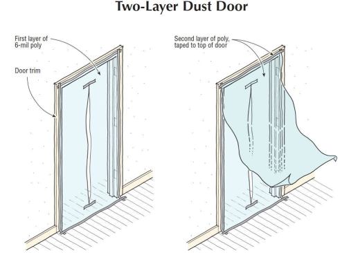

Doorways. In a case such as this, the entrance to the job could be through a swinging door that's fully sealed on every side with some type of weatherstripping; but it's also possible to fashion an effective airlock using duct tape and two sheets of 6-mil plastic. On the days when dust is flying, workers should always remove their protective garments or vacuum the dust off of their clothes and shoes before leaving the work space.

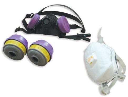

Respiratory protection. By now, everyone knows that a cheap paper dust mask offers no protection from hazardous airborne dust. If you're a demolition specialist or a painter who's routinely exposed to lead dust, you need to wear a properly fitted, half-face respirator that's equipped with HEPA (purple) filters. If you remove paint using heat or chemicals, your respirator must be equipped with organic vapor filters (yellow) or with two-stage filters (purple and yellow) that offer both types of protection.
Nobody likes to wear a respirator; and fortunately, most remodelers don't have to. If your work brings you into contact with lead dust on an occasional basis, all you need is an N100 series disposable respirator (3M Co.; 800/243-4630; www.3m.com). This nifty device meets the same HEPA filtration standards as a purple-filtered respirator, but it's much more comfortable. Although a single mask costs about $8, it should last a worker for the duration of a typical job.

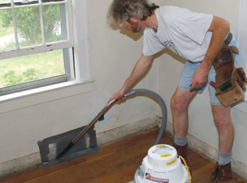

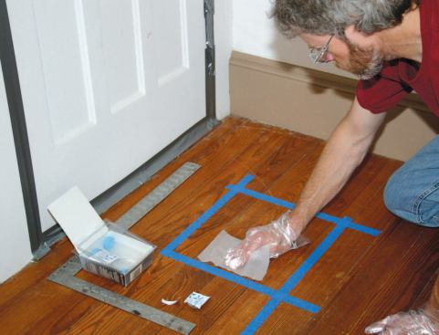

Experts tell me that vacuum cleaning may not suck up every bit of lead dust — especially if you've used water to control the dust — so the final clean-up requires washing as well as vacuuming. The standard procedure goes something like this: After carefully folding and discarding the plastic floor covering, slowly vacuum all horizontal surfaces using a HEPA or other high-filtration vac; pay particular attention to crevices and cracks between floorboards. Finally, you should scrub all of the horizontal surfaces with a strong household detergent and empty the dirty rinse water into a toilet, never a sink or bathtub.
Before the barriers come down, you can verify the effectiveness of your cleaning process by swabbing a section of the floor with a wet wipe and sending it to a testing lab. If your clients have young children and are worried about their exposure to lead, you might choose to have this testing done by a third party. (To locate a qualified lab or third-party testing service, visit www.leadlisting.org.)

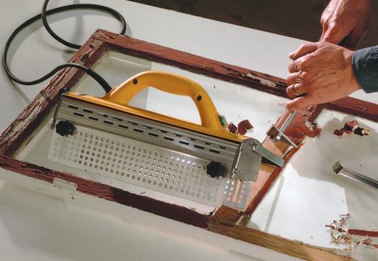

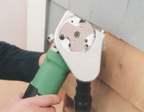

Paint removal. Don't use unshrouded power tools, belt sanders, or torches to remove paint. I've had good luck using the Paint Shaver (American International Tool; 800/932-5872; www.paintshaver.com), a shrouded grinder that's attached to a tool-actuated vacuum.

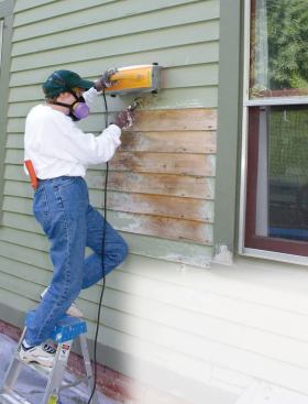

Recently I also started using the Silent Paint Remover (Viking Sales; 585/924-8070; www.silentpaintremover.com), which loosens paint using infra-red heat. Stripping paint takes longer with this device, but it's quieter and less grueling to operate. Respiratory protection should be worn when using either of these tools.
