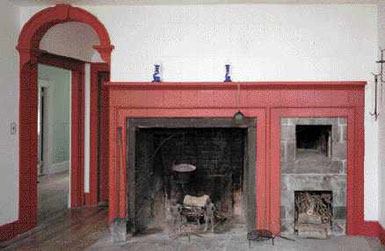

Last spring, as part of a discussion of traditional New England trim in JLC Online’s finish-carpentry forum (search on “New England home details“), Jim Chestnut posted a great explanation of the benefits of the traditional jack-mitered beaded casing joint (1, 2):
“Beaded casing is an excellent choice, with or without plinths or backband. Its biggest advantage is versatility. If you use a backband, the bead can be jack-mitered, the rest of the casing butted, and the backband mitered. If you wish, the jack-mitered legs can be pocket-screwed together before installation. You’ll have no problems with wood movement using this method. “Another advantage is that you can vary the widths of the flats as needed to fit in tight spaces, which is not possible with highly detailed profiles. For instance, if a cabinet starts a little too close to a window, you can make the casing for that window slightly narrower than in the rest in the house and no one will ever notice. Upstairs, if you have a closet door jammed right next to the bedroom door, you can use a single jamb casing between the two doors, with beads on both edges jack-mitered into the single head casing that runs across the top. Then install a backband up one door jamb, across the top of the continuous head casing, down the other jamb, and it looks like the architect knew what he was doing. Likewise, it’s easy to make adjacent windows in a window wall look mulled together using this technique.”
