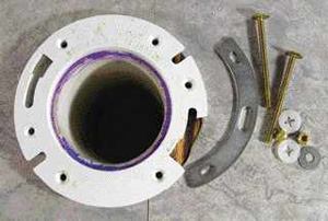

This problem can be fixed with an inexpensive, crescent-shaped metal part called a spanner flange. Slipped underneath the edge of a broken plastic or metal flange, the spanner flange bridges the broken area and provides a secure mount for the closet bolt.
Some spanner flanges have predrilled holes that allow them to be easily anchored or screwed in place, but in some instances anchoring to the floor is not possible or even necessary.
When only a small section of the closet flange has broken away, for example, a heavy spanner alone can provide sufficient strength once it’s slid securely under the remaining portion of the damaged flange. With larger breaks, however, I try to anchor the spanner with screws when working above wood flooring, or with lead anchors when working over concrete.
Sometimes the top of the closet flange is set below or even with the floor surface, which can make it difficult to slide the spanner flange into position under the broken flange. In such cases it’s usually easier to simply anchor the spanner in place on top of the flange instead of underneath it.

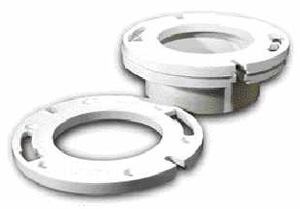

Once I’ve removed a flange, I can replace it with any of several different types of plastic flanges designed for retrofitting into the remaining drainpipe.
For example, Oatey’s cast-iron flange replacement (888/466-2839, www.oatey.com) has an expandable gasket; once the fitting has been inserted into the existing 4-inch cast-iron or plastic drainpipe and secured to the floor, the gasket seals the flange to the inside pipe wall. This fitting comes in both PVC and ABS plastic. Plastic replacement flanges are also available in sizes that fit tightly inside 4-inch and 3-inch PVC and ABS plastic pipe. Once the top or flat portion of the old flange is removed, these fittings are solvent-welded inside the pipe.
Whenever I’m using a 3-inch replacement flange, I check the outlet of the toilet bowl to be sure it will fit inside the flange opening. If it won’t, I lower the flange so that it sits flush with — or slightly below — the finished level of the floor; the flange and bowl outlet should not touch when the bowl is set. No matter what fitting I use, I make sure it’s screwed or anchored firmly to the floor. Otherwise, the flange could be pulled loose as the toilet is tightened above it.

When flanges are only slightly low — 3/4 inch below a slab floor or 3/8 inch below a wood floor — I compensate with 3-inch closet bolts (standard bolts measure 21/4 inches long) and double the wax rings.
But with truly low flanges, I install a flange spacer, which is essentially the top portion of a flange sealed to the original flange surface.
Since flange spacers are easy to install and inexpensive, I use them whenever I’m in doubt and don’t want to risk a leak; multiple spacers are acceptable as long as they are sealed between each layer. (Keep in mind, though, that some manufacturers recommend no more than three.)
After I stack and seal the spacers — some manufacturers specify RTV (room temperature vulcanizing) silicone caulk, but some designs can be solvent-welded together — I drive long screws or anchors through the layers until either the screw threads into the subfloor or the anchor penetrates any concrete around the drainpipe.
Then I set the toilet in the normal fashion with a wax ring and closet bolts.
