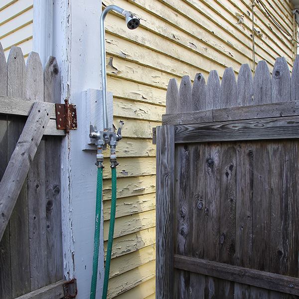

The shower fixture is very basic and inexpensive: Faucets and gooseneck shower head. Garden hose makes up the supply pipe.

Interestingly, this day presents a quandary on many levels. The most immediate level is making the decision to go through the “turning on” process. Yesterday afternoon was sunny and warm with temps in the 50s. I checked the 10-day forecast and no below-freezing temps were predicted. So I decided to go for it. I grabbed my Teflon tape and wrench and jumped into action. Outdoor showers can be elaborate and luxurious—mine is neither. The privacy walls are sections of stockade fence, and the fixture itself is an inexpensive cast-iron rig with two shut-off valves and a gooseneck for the shower head. Most hardware stores sell them for under fifty bucks. I added threaded fittings to go from the fixture to two lengths of garden hose. The other ends of the hose connect to hot and cold fittings inside the bulkhead next to the shower. Turning on the shower is quick: thread in the drain plug on the fixture and close the valves, hook up the hoses and open both shut off valves all the way. Then at the shower, I bleed the air out of both sides and let the water run for a couple seconds to wash out the winter rust and debris. The final step is screwing on the shower head. Wap, done! Less than 5 minutes even with wrapping all the fittings with tape before making the connections. Not that I don’t trust the weather people, but last night I checked the thermometer in the shower. It was a clear night and the temperature was around 35. I ruminated for about 10 seconds, and then latched the door to the shower and went to bed.
