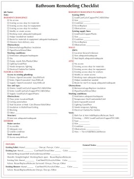

To avoid problems, it’s important that during the initial site visit you work through a of the common problems that typically plague bathroom remodels, especially when it comes to investigating existing piping and fixtures. Until you’re comfortable with this kind of detective work, ask your plumbing sub to visit the site with you. You’ll look like a hero to your client if you underpromise and overdeliver, and your plumber will be a lot happier if, before saying “No problem, my plumber can do that,” you actually talk to your plumber about “that.”
