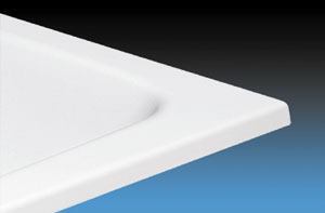

There are two types of whirlpool installations: island and alcove. Although the photos of island (or drop-in) installations look great in manufacturers' brochures, few of the bathrooms I work in are spacious enough to accommodate an island tub (see Figure 1). In any case, since most customers want to be able to shower in their tub, they usually choose an alcove installation.
Figure 1. Tubs designed for island installation are self-rimming, which means they lack a tiling flange. Self-rimming tubs, like this model from Aker Plastics, require a site-built skirt. |
