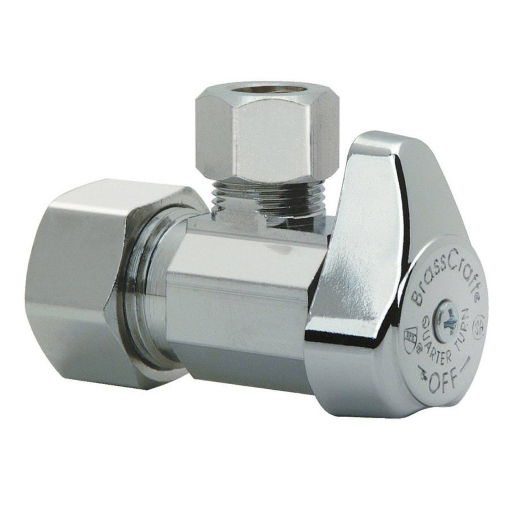

1/4 Turn Ball Valve stops for toilets are incrementally more expensive but much better.
Plumbing is a huge topic and isn’t easy to cover in one blog post but here’s a few rookie mistakes that I’m seeing in the field.
Mistake #1 – Cheap Plumbing Materials & Fixtures
The materials your plumber uses can make a big difference in the final quality of your homes. Rookie builders don’t pay much attention to the finer details of what the plumber is installing.
For instance: I use all 1/4 Turn Ball Stop Brass Shut off valves for my houses (I like the KT Series from BrassCraft). These will last for decades and be leak free in 30+ years when you need to turn them off! They run about $11-15 each.
If you are taking the lowest bid on your plumbing (and you’re not specifying) you’re going to get these cheapie shut off valves that run about $3-5 each. In my remodel experiences, I’ve seen these fail in under 15 years of service quite often.
I also think this holds true to the plumbing fixtures themselves. I’ve found that the cost of the fixture directly relates to the quality and longevity of it’s service life. I don’t want to bash any plumbing brands, but if you buy quality fixtures from Kohler, Grohe, or Toto you’ll get the quality that comes with the higher price tag. The less expensive brands seem to have issues inside of 10 years. Rookie builders buy based on price, experienced builders will pay for the quality.

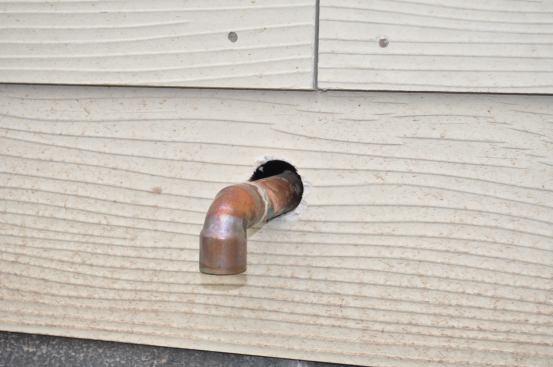

Mistake #2 – Plumbing Penetrations

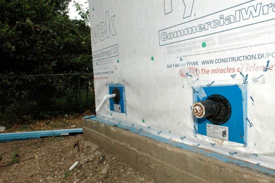

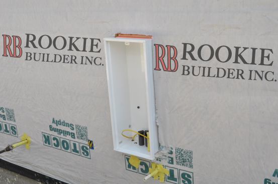

The plumbers are your #1 hole-maker in a house. They arrive onsite at the “Top-Out” stage (where the house is framed and they run the pipes inside the walls pre-sheetrock) and start drilling. I’m going to mainly focus on exterior envelope penetrations, but this also goes for making holes in your structural components too. The rookie builder gives the plumber no direction on how to fix holes in the weather barrier. Here’s an common example I saw a few months ago. This is a recessed exterior tankless water heater box that comes into the inside envelope, and notice the yellow “duct tape” the plumber used to seal the holes in the weather-resistive barrier (WRB). There are multiple errors here and I was dismayed to see the mason on the house next door putting up his rock over this WRB with it’s penetrations. Not good. Rookie mistake.

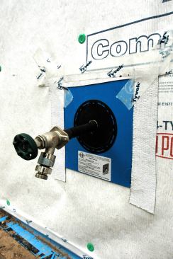

Experienced builders have a plan for exterior plumbing penetrations and their plumbers know how to handle these holes in the critical air and water barrier for the house. I’m a big fan of the Quickflash plumbing boots and use them for my “holes” in the WRB. Here’s the Quickflash P-50 panel that goes on every hose bib penetration.
Here’s a link to a how-to video I shot 4 years ago where I’m installing one of these.
I used to stock up on these flashing panels and carry a huge bin of them from Job to Job, but now I’ve persuaded McCoys Lumber in Austin to stock them. I still provide them to the plumbers, but they are trained to always use them and ask if they aren’t on the site. Bottom line: Rookie Builders leave the critical air & water barrier up to the plumber and experienced builders are serious about their envelope. We must take this issue seriously as these small water/air intrusions will make a huge impact on the longevity of the house.

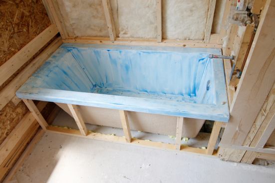

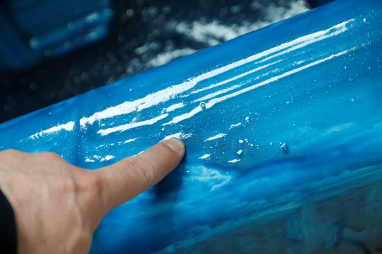

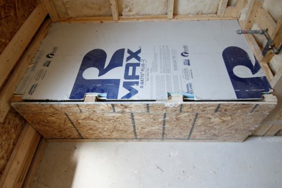

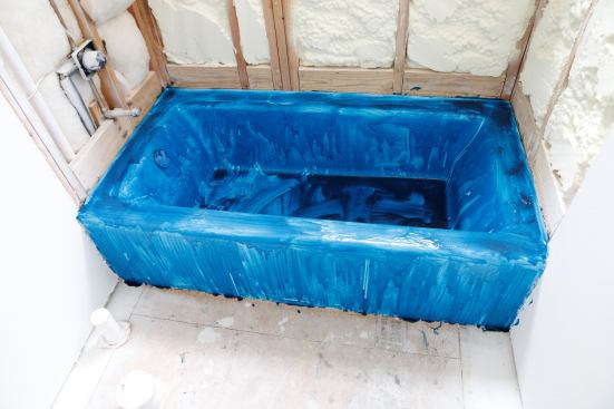

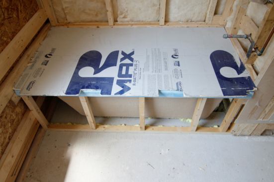

Mistake #4 – Protection

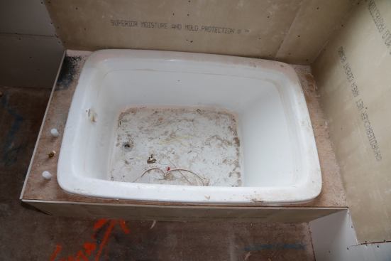

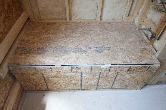

Rookie Builders fail to protect installed plumbing! I’m mainly talking about tubs here, but this applies to all sorts of finished items that are in contact with trades in the final months/weeks of construction. Tubs are especially prone to damage as they are usually installed pre-drywall and get bombarded with junk during construction. One huge culprit of tub damage is drywall nails left in tubs that later get ground into the finish by people stepping into the tub.
